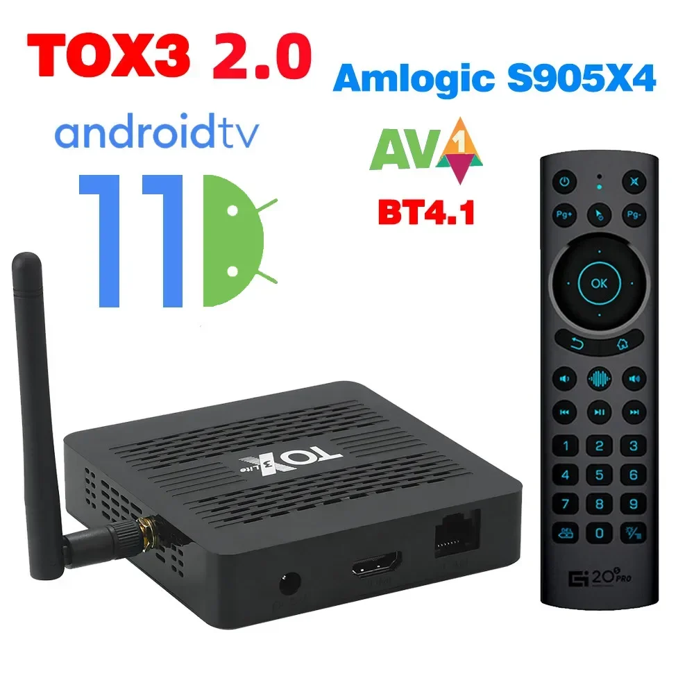

For CE I have an TOX3. S905x4 Gbit
Not DV but I don’t need that only HDR (Samsung TV’s)
Just works and for some of us poorer people $64au~ currently.
