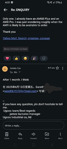

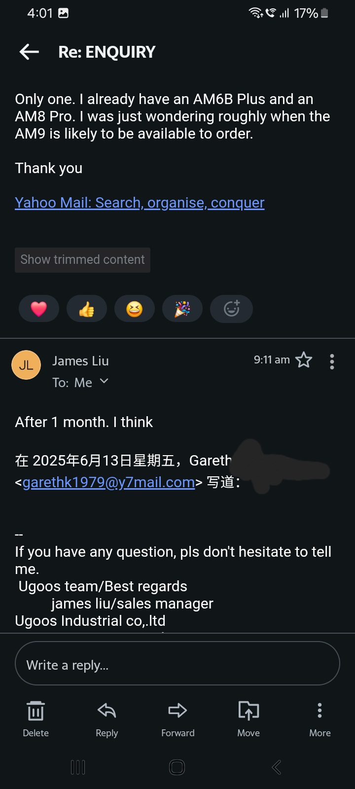

I was emailing with a bloke from Ugoos who informed me about a month to go until their AM9 so that’s good news
Next time use copy/paste of the text only.
