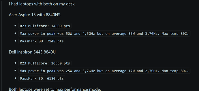

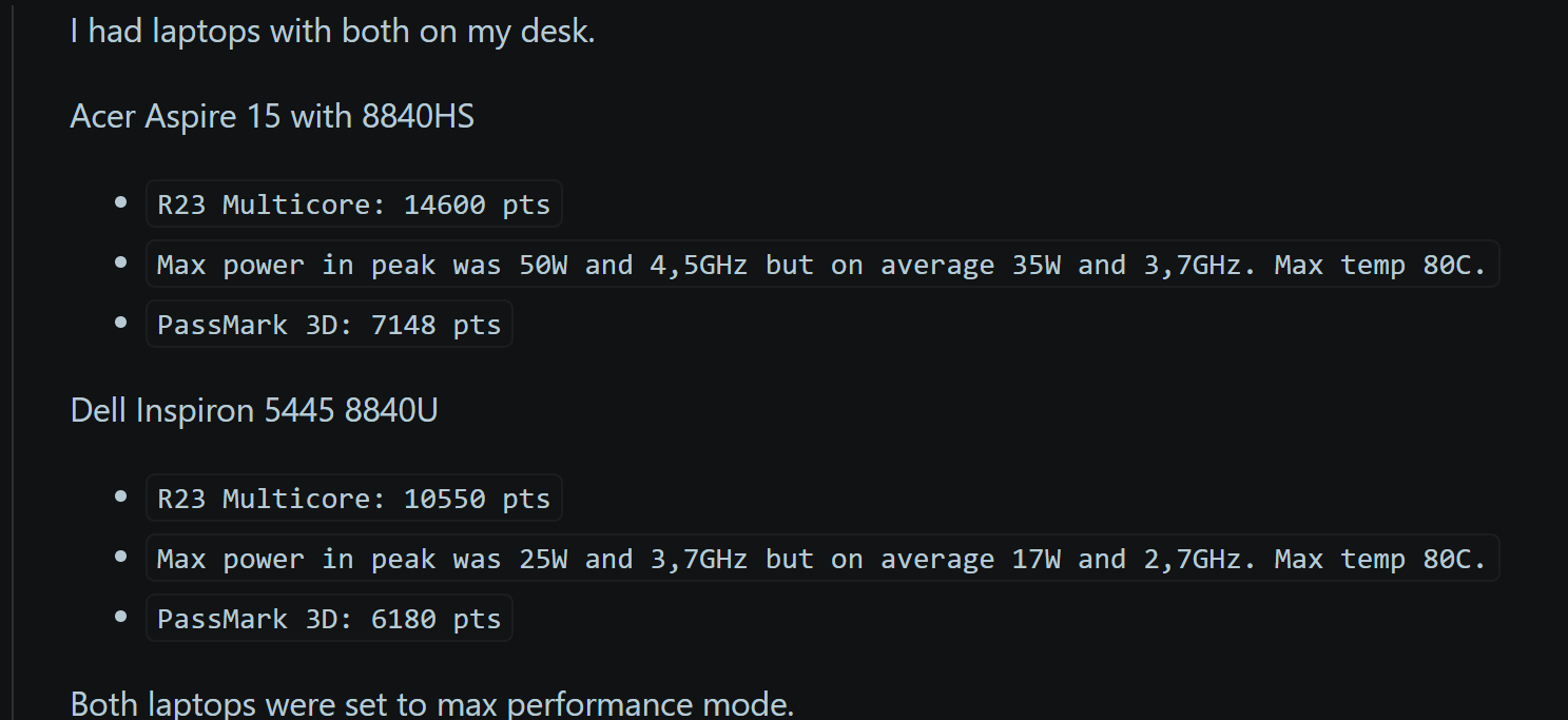

the 8440U is probably the best device if anyone is interested in Kodi on Windows. someone I know is in the process of buying this box and I’m interested in the performance, according to this
https://www.reddit.com/r/AMDLaptops/comments/1ee6jur/8840u_vs_8840hs/
The cooling solution on this is awesome too (same box has 54W rated chips while the 8840u is 28W rated), so can see it running 15W while Kodi is playing. and single core will be good enough that it beats a S9228X for kodi in windows even. anyway will be reporting the Python single core when he gets round in benchmarking it on the community sheet I’m updating.
