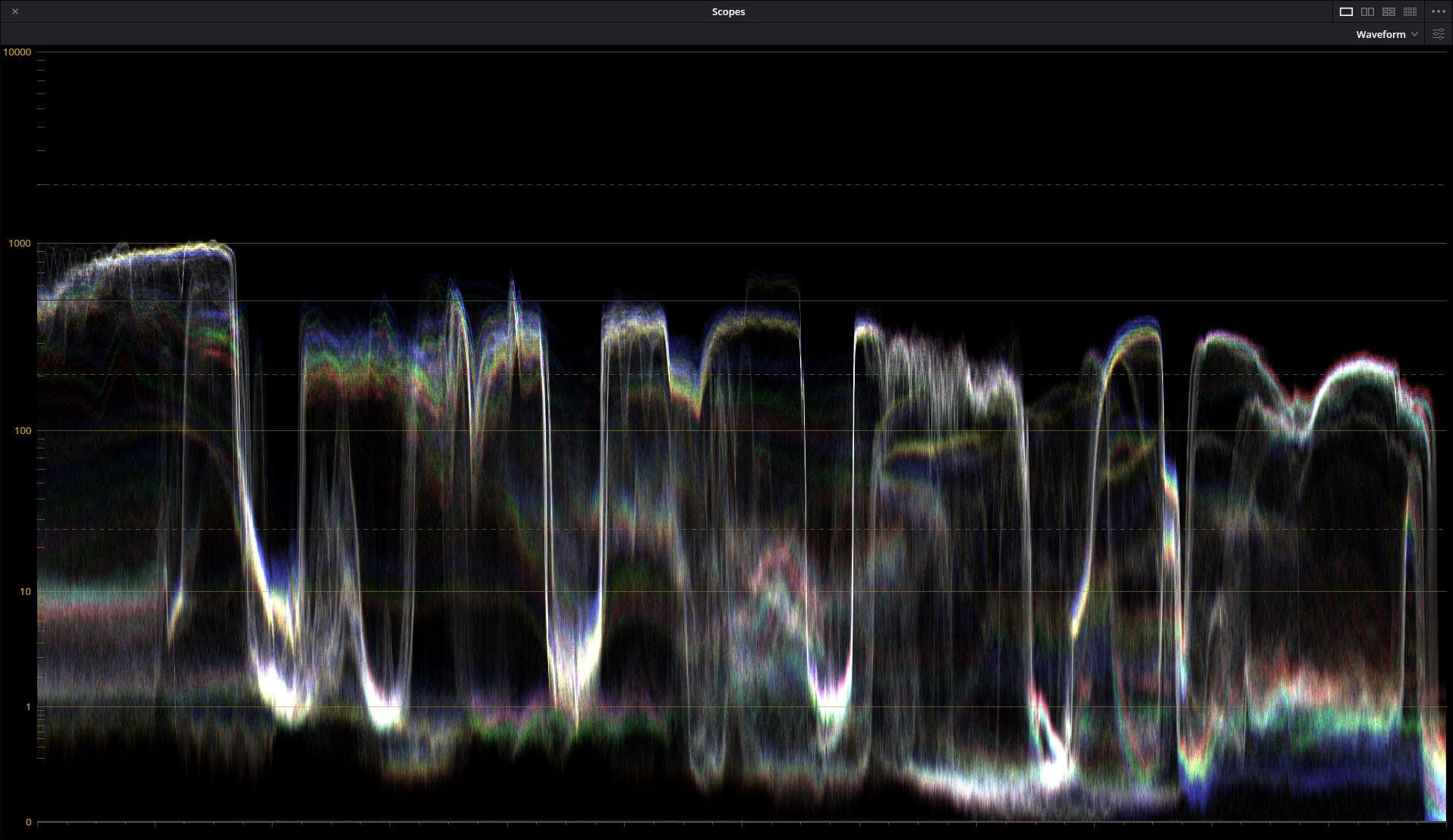

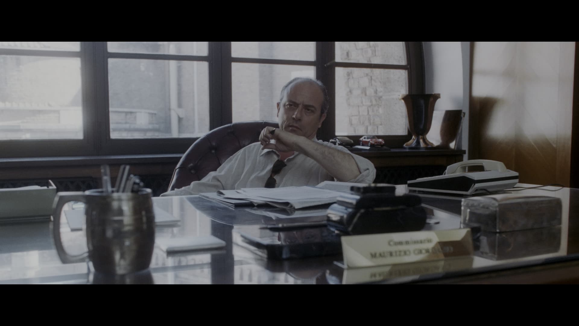

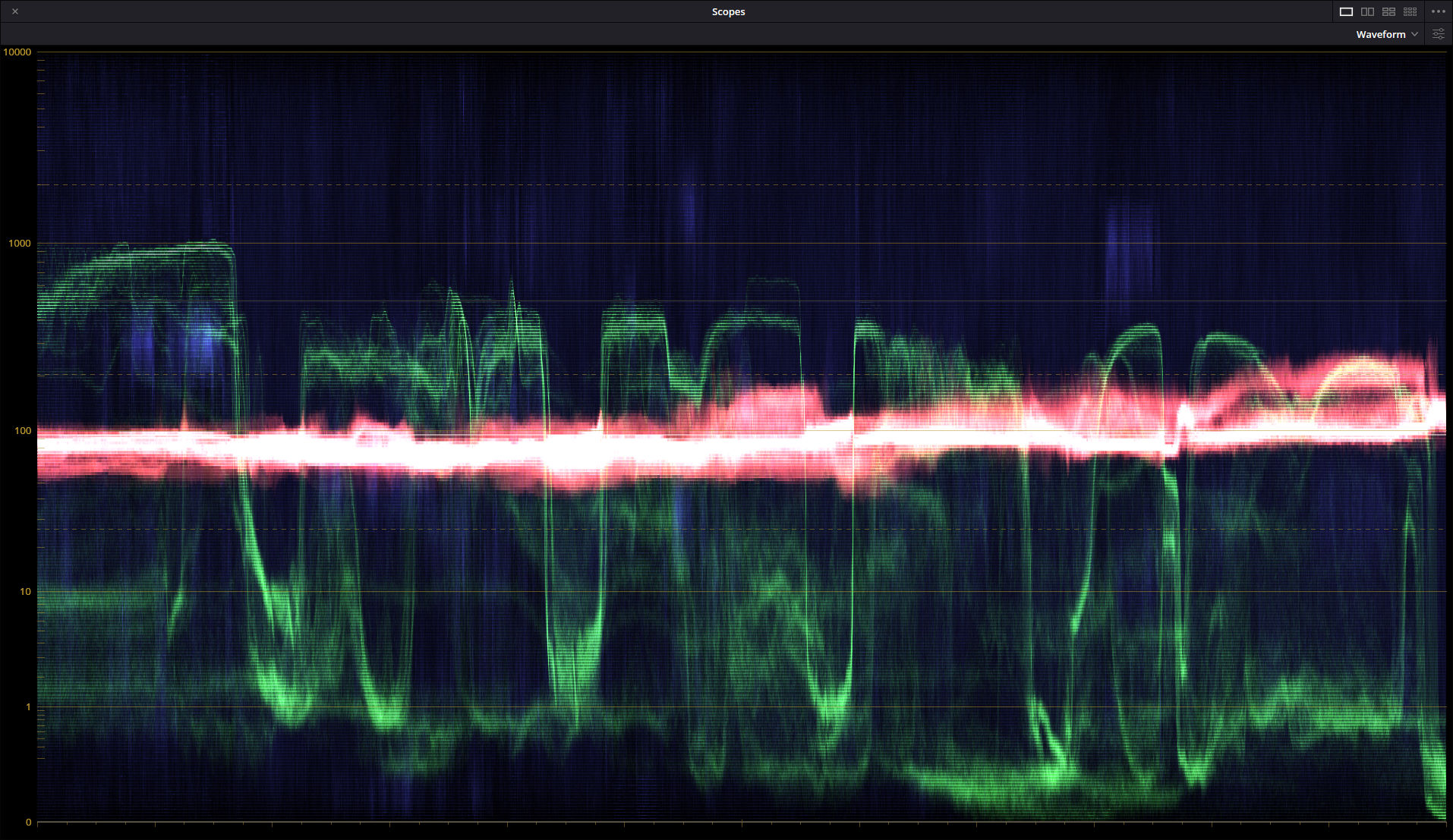

Very cool. If convenient for you, could you please post a waveform and screencap of the original HDR?
From eyeballing, the results are close to the native DV in color, but slightly reduced brightness. Impressive processing.
Makes me want to rewatch Planet Earth III with VS10 turned on.

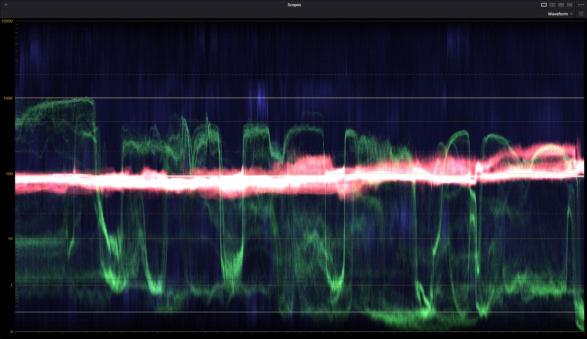

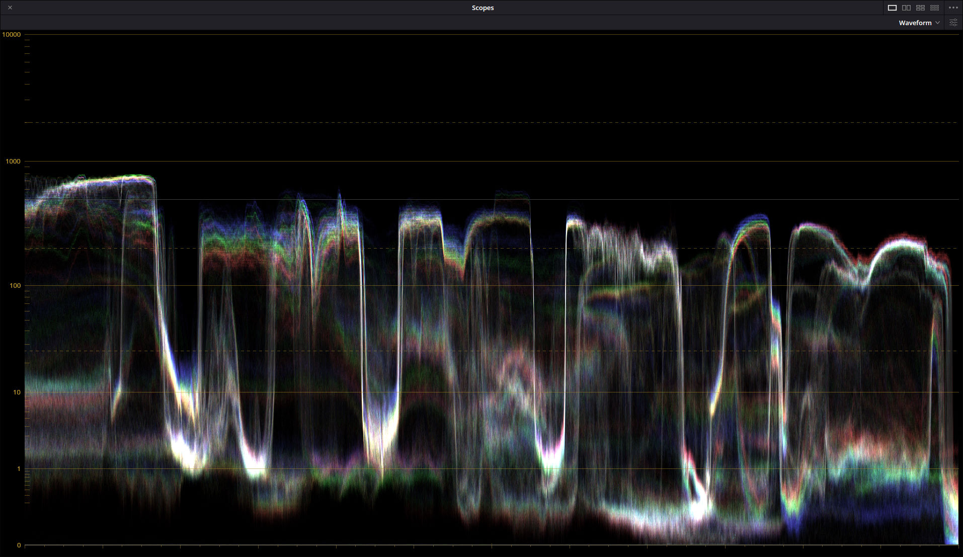

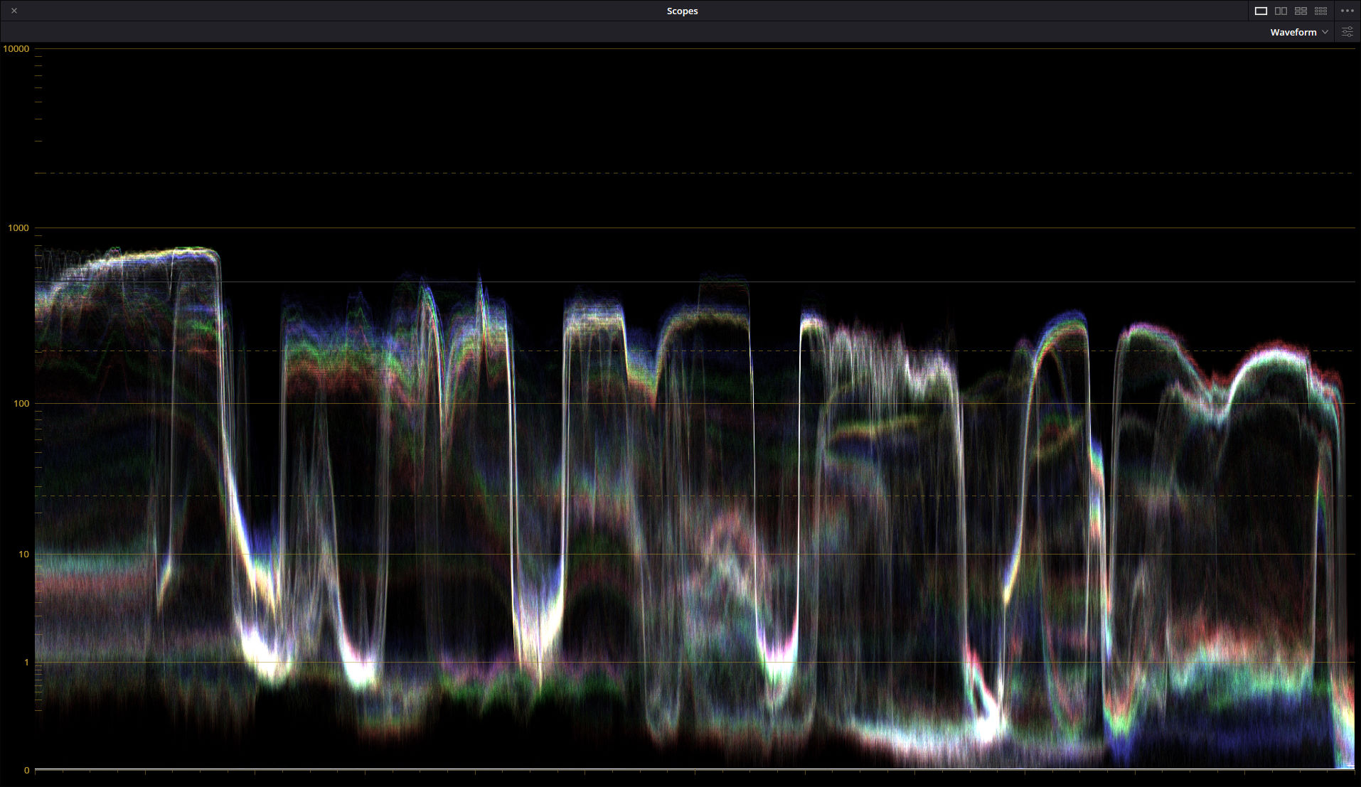

That’s right. HDR to DV does not differ in colors from the dv version, the only difference is lower average brightness, but the brightness peaks are compressed correctly. But in tv-led output mode the result will be better because cm4.0 will be used for conversion.
The difference in color with the original HDR is due to the fact that for DV used EDID CX, so the image is more red.
