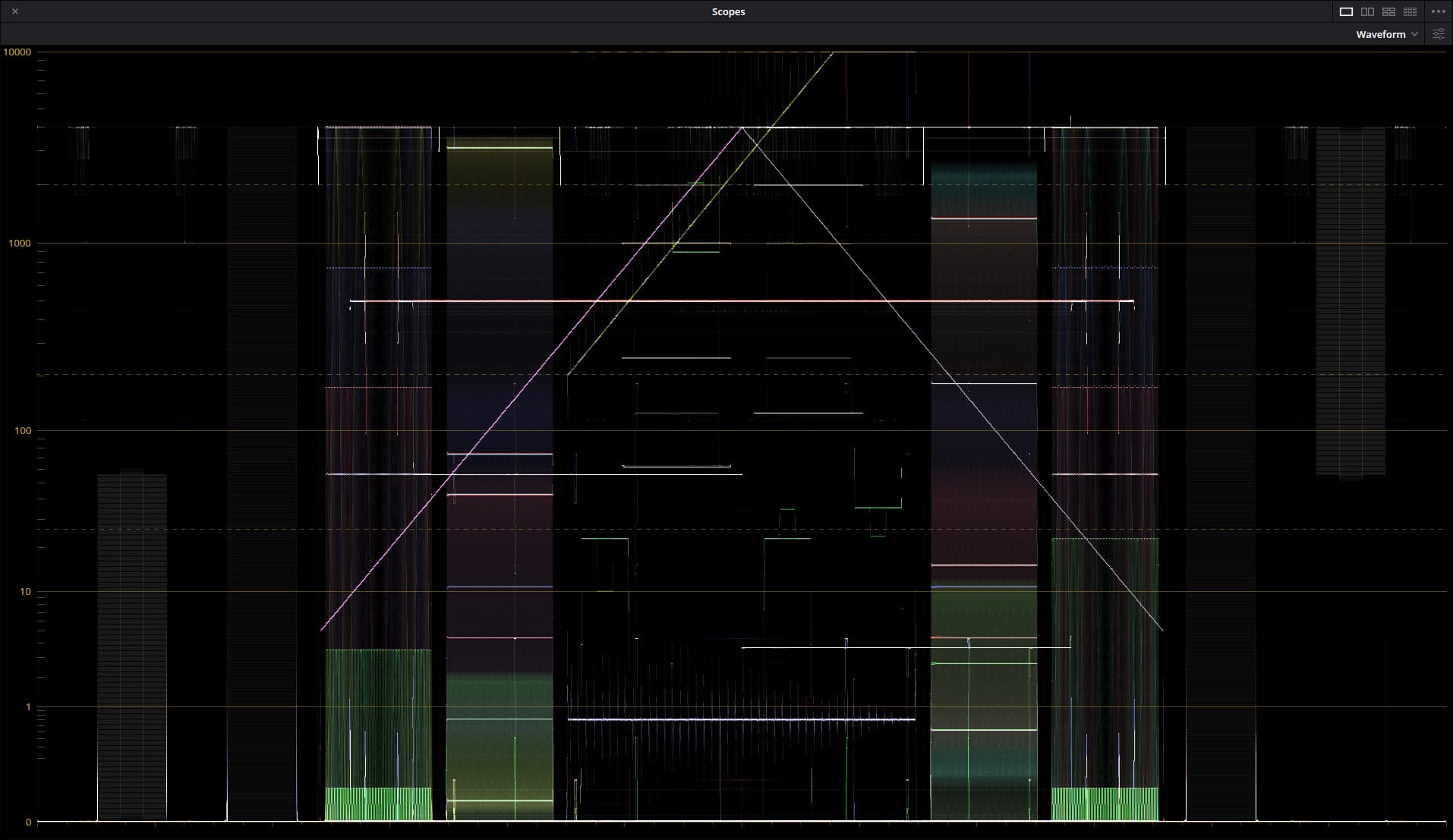

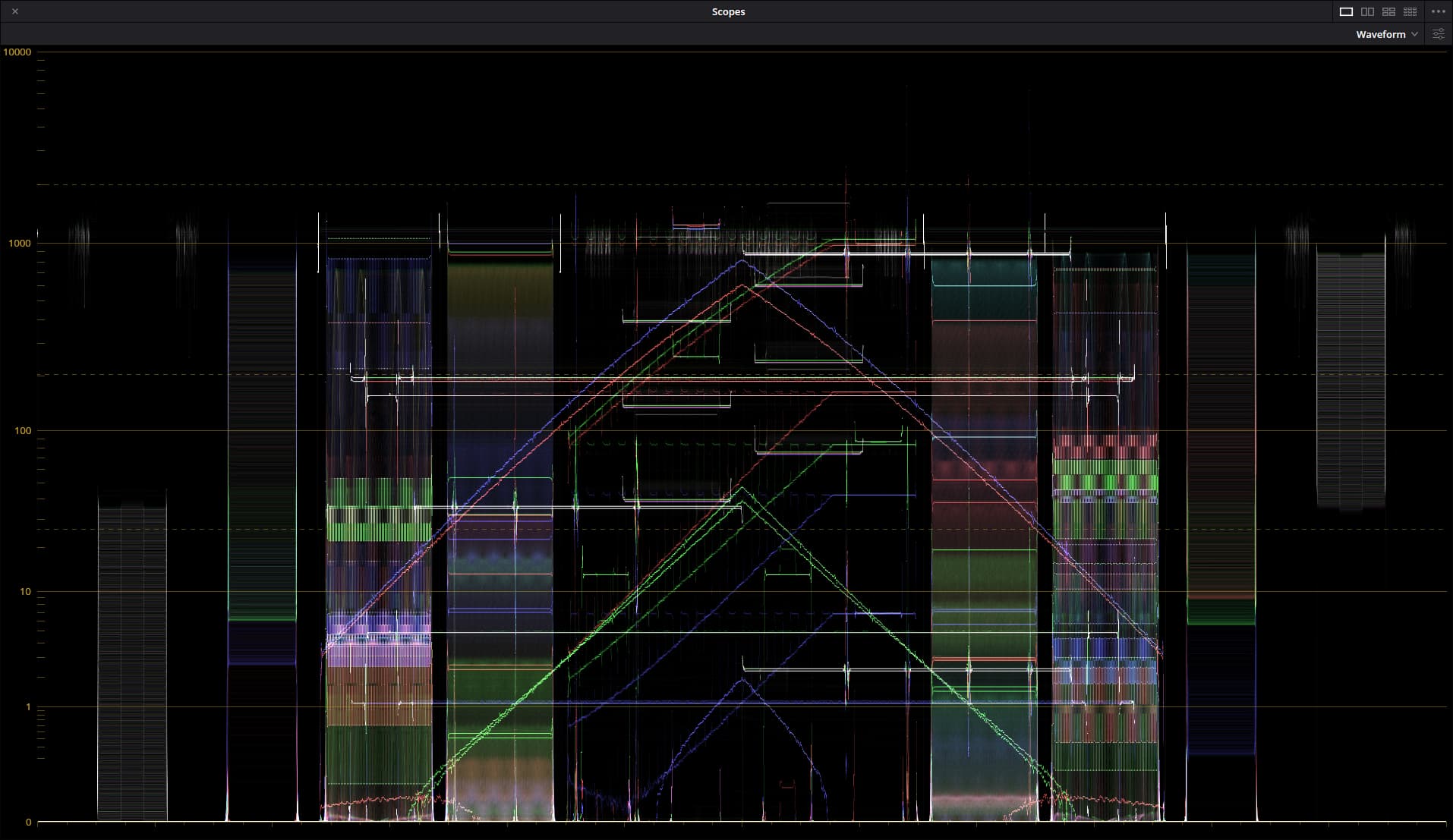

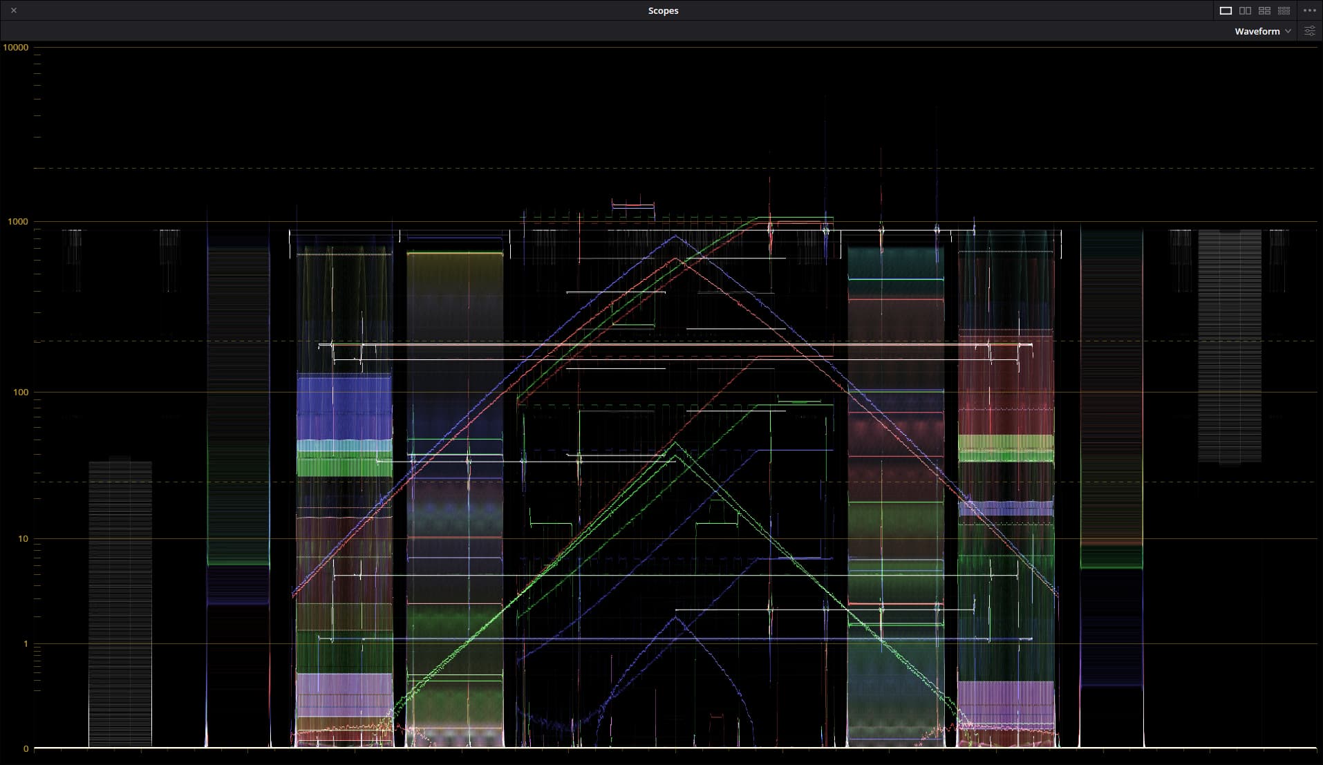

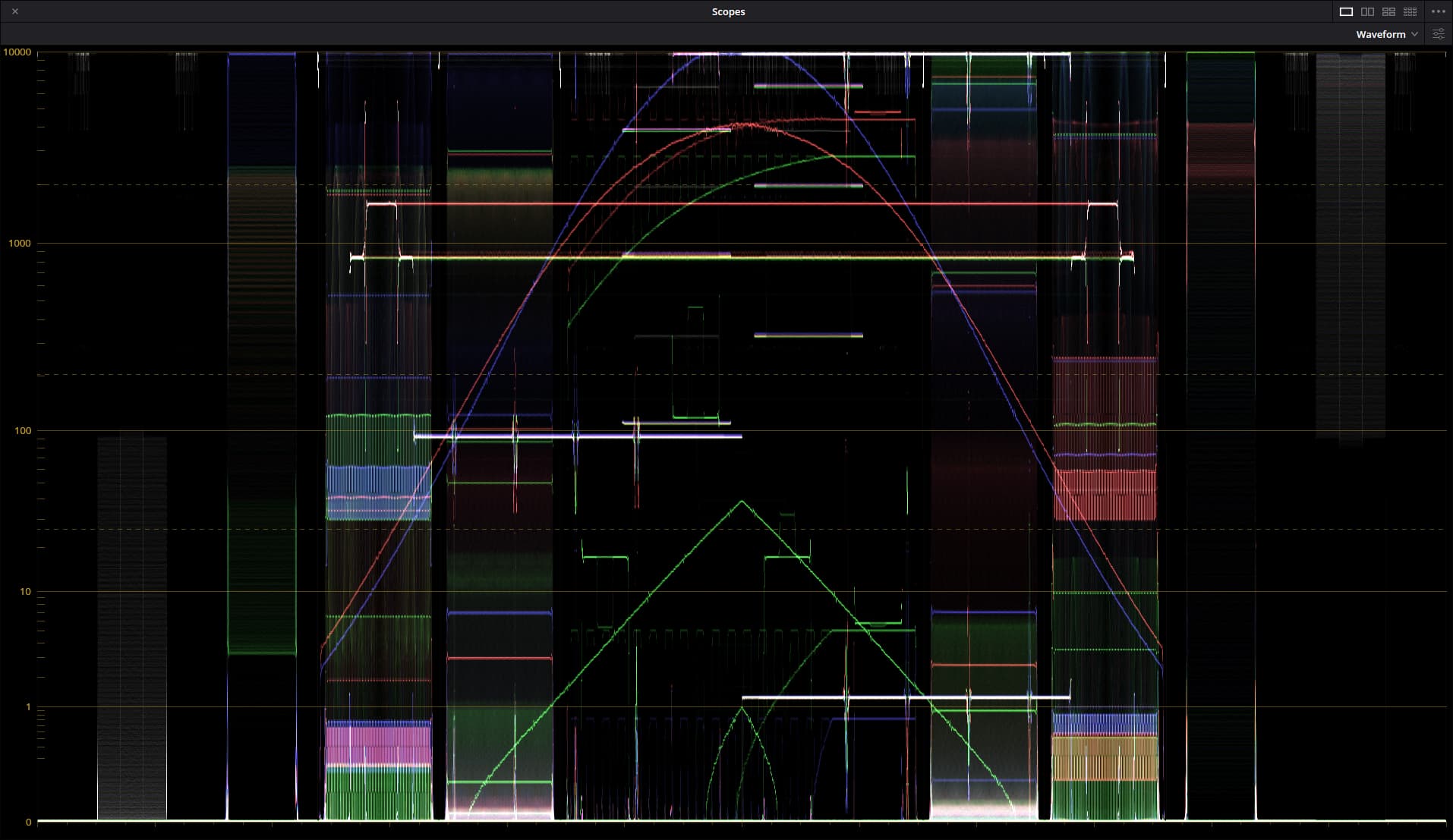

first results, am6 vs10 hdr to dv with edid LG C2. Video HDR table 4000. am6 wins over dune 8k. Dune’s brightness was out of bounds due to over sharpening, am6 did tonemapping more accurately. Color gradients are also better with am6, but I think that’s because of the over-sharpening

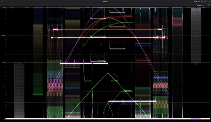

HDR to SDR. Very good result
second graph, its Dune 8k (trouble with upscale function)
