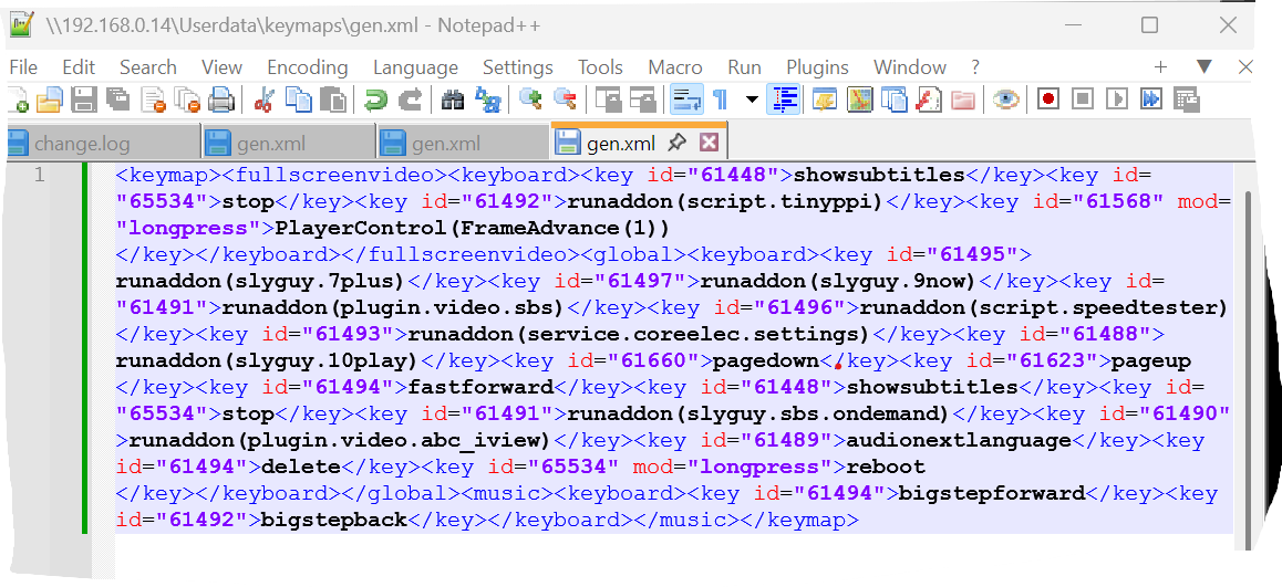

Thanks. Will try to find a key id to use :slight_smile:
I used Notepad++ . Others gave issues. Thanks :slight_smile:

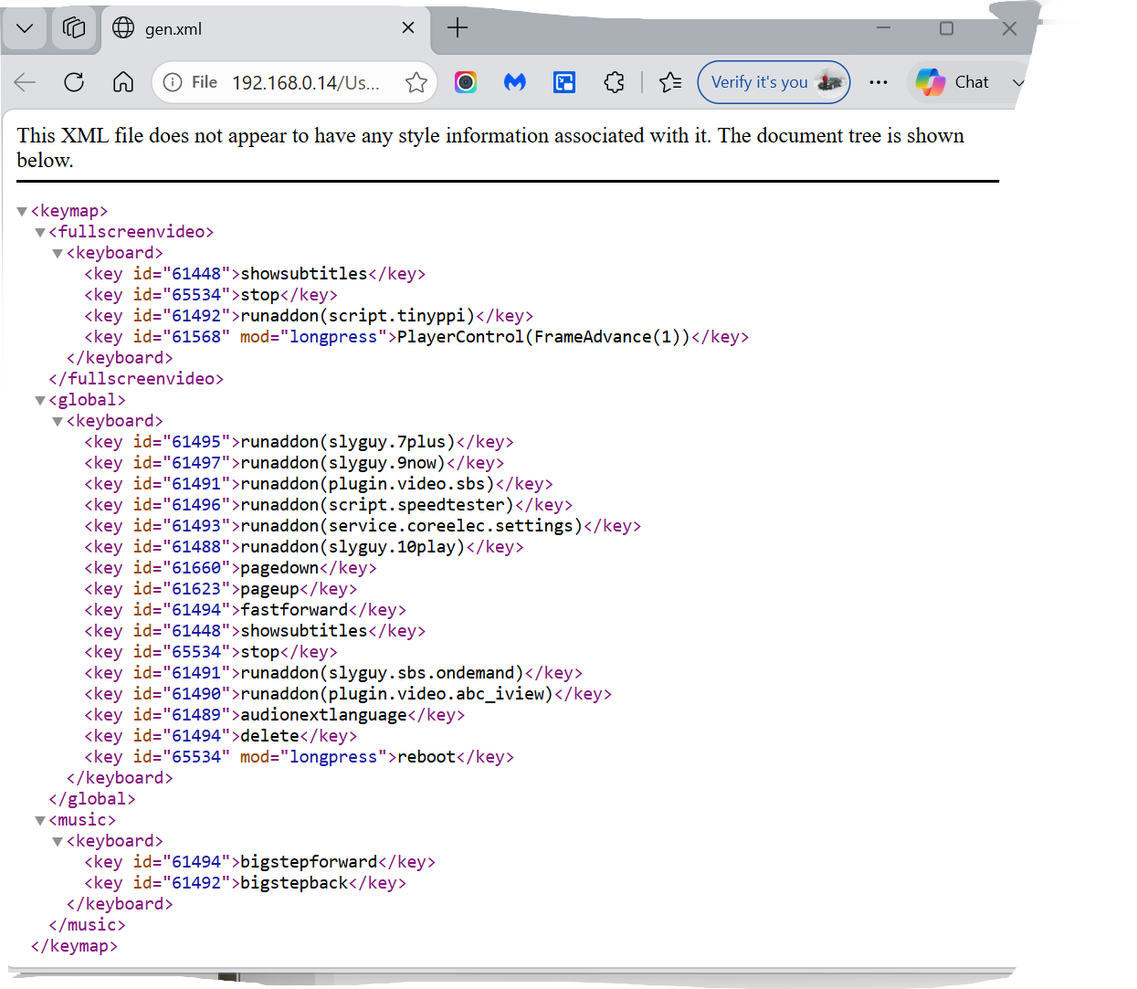

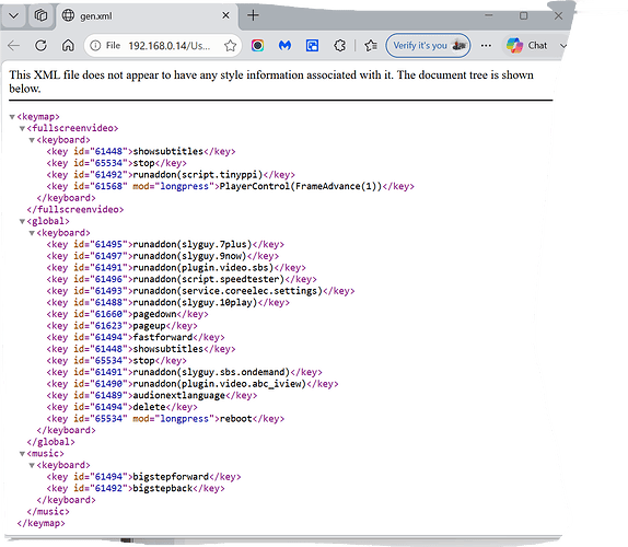

File with formatting open nicely in Microsoft edge but cant be edited there. This helps to view the file.
As shown in wordpad++

How is Progress? Notepad++ is best.
Maybe you already tried/know this . When you first open xml file,you need to Save As (All file types),not xml file format
After you edit, same thing Save As All file types)
