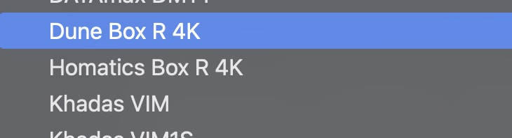

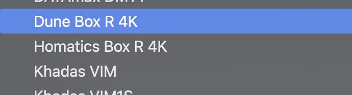

I want to install coreelec on my Homatics Box R 4K Plus and I have a few questions.
1st will Coreelec 21.1.1-Omega work on my device and in installation menu should I choose Homatics Box R 4K ? because there is no plus in the name
