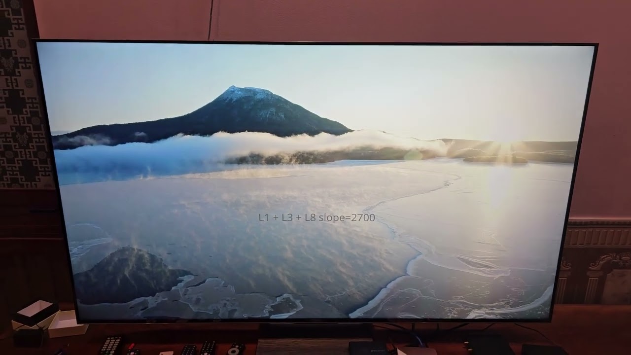

have you try playing some Dv movie with it ?
Yes, DV working, My Test Video
That is amazing, truly amazing.
