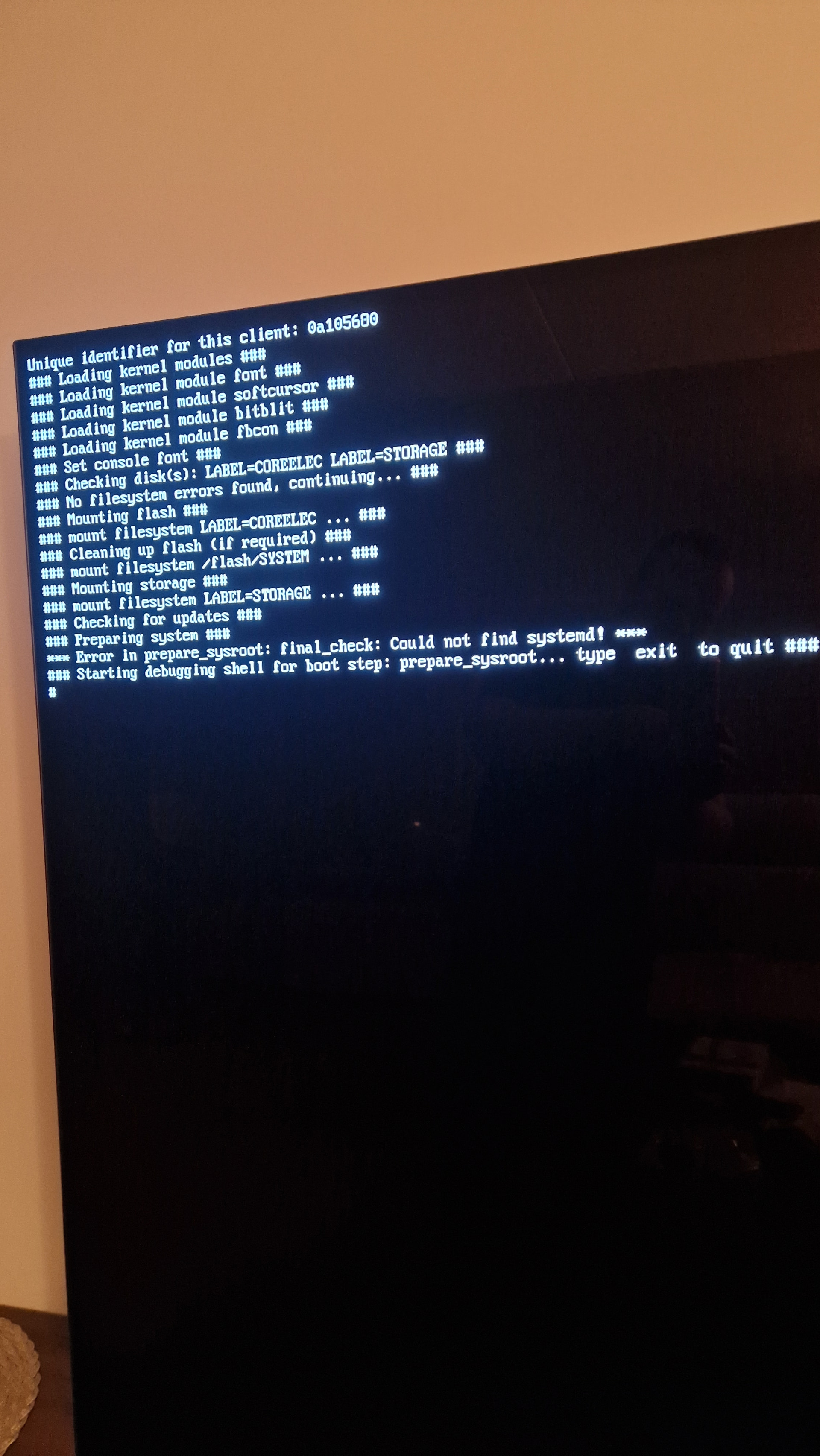

So, this happened for me. Should I prepare the usb from scratch, or is there something I could try with current installation? I have CE NG, latest nightly I guess, on the Dune box, seems like the booting process degraded gradually, but the usb drive should be fine, it’s quite new samsung fit drive 64GB.
Sometimes it hangs on starting services, update-bl301.service, wsdd2.service
Using usb3 port seems to have improved things. But I liked keeping the CE usb in the USB2 port, to save the USB3 for occasional external HDD use as source for playback. Can the USB2 be failing slowly? Is there a way to check this? :slight_smile:
P.s. sorry if my picture breaks the display grid of the forum, I can remove it
In your case I would still use the USB3 port and the USB2 port for connecting your storage. It should be fast enough for data distribution (playing media), and with using the USB3 port and a fast USB storage, you get a nicer CE usage overall.
