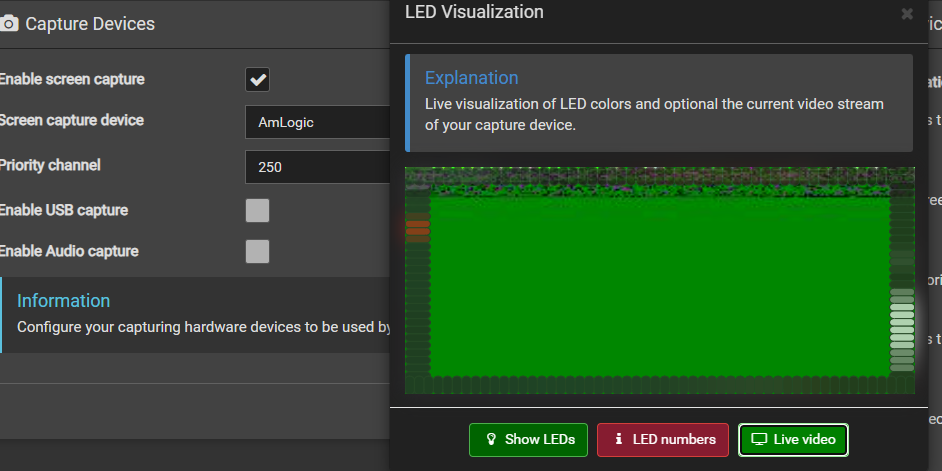

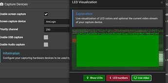

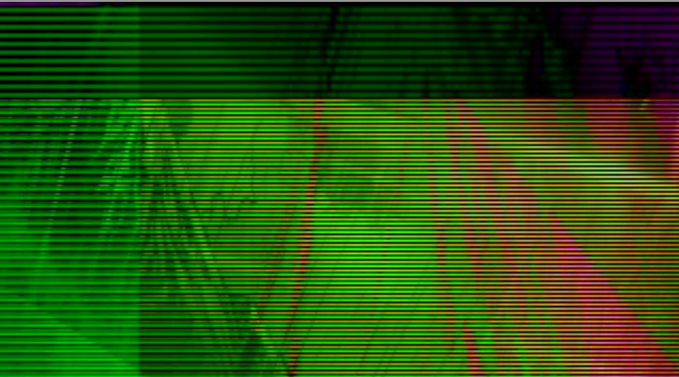

Last night c22-no - gtking s922x - when playing Disney DRM, the backlight is green - it doesn’t match the colors. On IPTV and some regular files it works fine.
screenshoot from hyperion panel config - as you see - is green - but on tv movie is ok…. colors are ok…
and screenshot - maybe it’s something with double write?
How to disable it?
