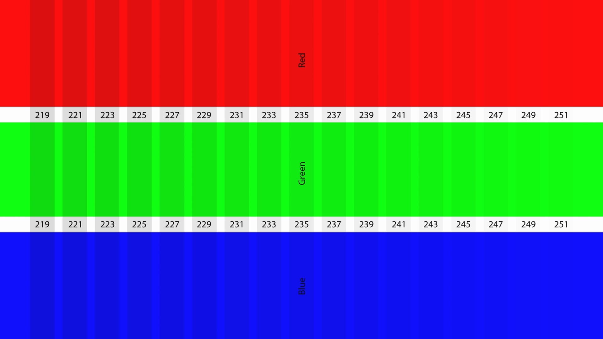

However, returning to the results from your captures. The values you have captured cannot be explained by a conversion from full to limited range RGB alone - but can be with incorrect color space conversions.
Taking the outer background as a concrete example. In the original png (full range 8-bit RGB) the value is (128, 16, 0) and the captured values are (119, 19, 17), even when included a conversion to align the ranges a significant differences (over 10) still exists.
However, the mp4 you made of the test pattern proved useful. This video is encoded in YCbCr (limited range), the values for the background are (49, 110, 178). These values correspond to a conversion from full range 8-bit RGB to YCbCr (limited range) using BT.709. Again, the values from the capture do not match a conversion back from BT.709 limited range YCbCr to limited range RGB.
What does, however, match the captured values is when the YCbCr values (obtained using BT.709 conversion) are incorrectly converted to limited RGB using the BT.601 conversion.
Oddly enough, this also appears to happen in the capture of the png. It appear that coreelec/kodi is taking the full range RGB image, converting to limited range YCbCr using a BT.709 conversion, and then incorrectly converting those values to limited range RGB using a BT.601 conversion. As to why a RGB image is being transformed to YCbCr and back in any form, I have no idea …

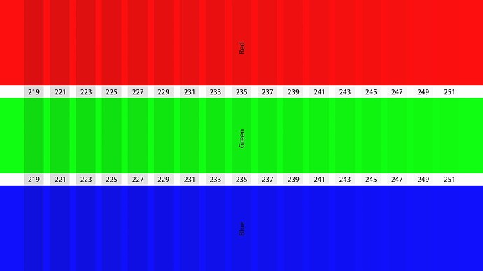

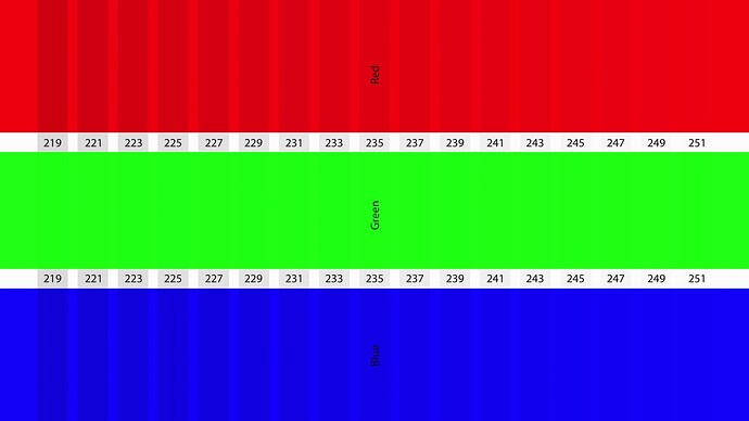

Here is the capture with rgb8 bit output and with YUV 8bit.
With rgb the green channel is lost. With yuv everything is correct.

I checked on my second pro capture card, I can do capture in rgb 8 bit.
Here is an example.
adding file test 8bit rgb2.avi

@DMDreview What is this a capture of? Seems very close, but not identical, to your earlier capture of the mp4 you made of that test pattern
Weren’t you already doing that with your previous captures, just with 2 bits of padding?
