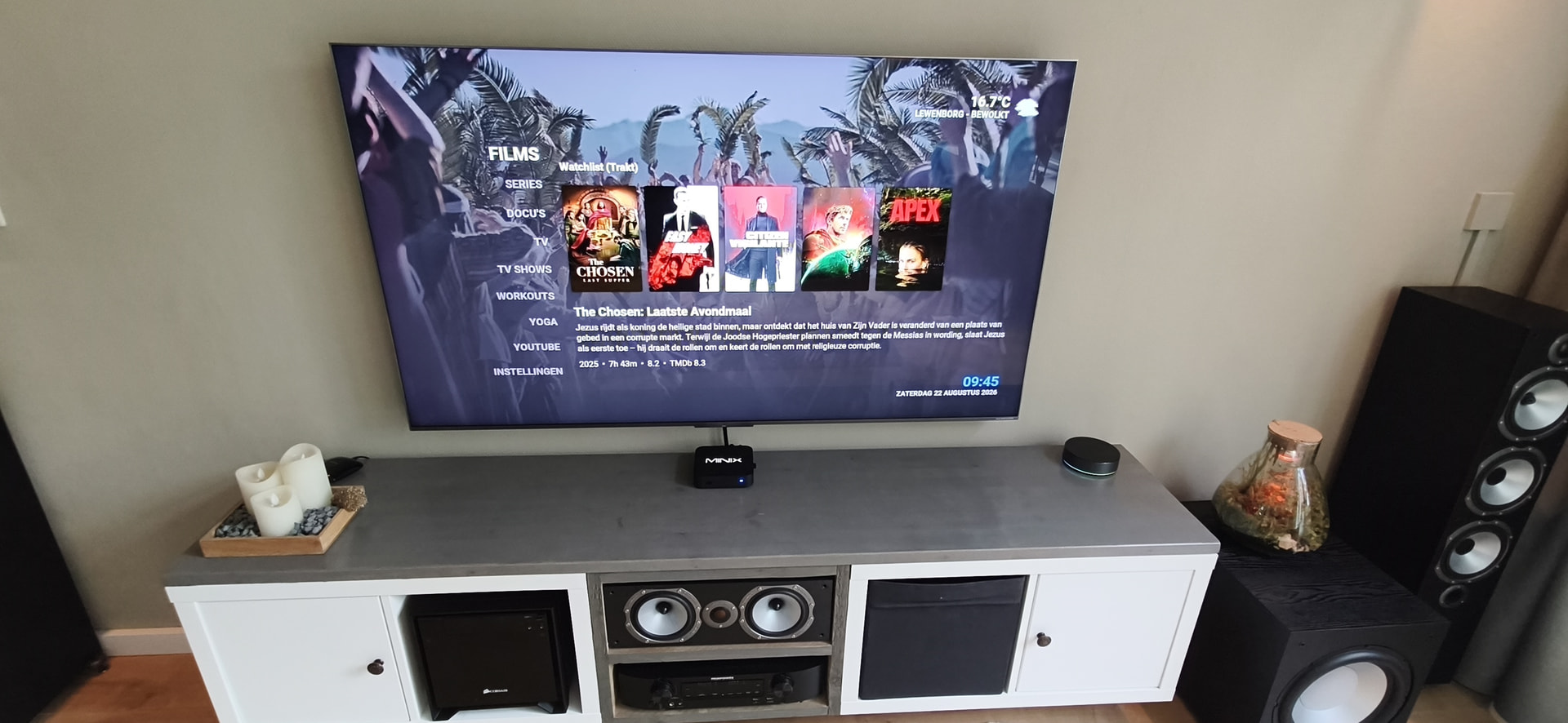

Thanks a lot @vpeter for the quick fix. It’s working perfectly.
I added the code to autostart.sh and finally there is some light in the dark! :sweat_smile:
