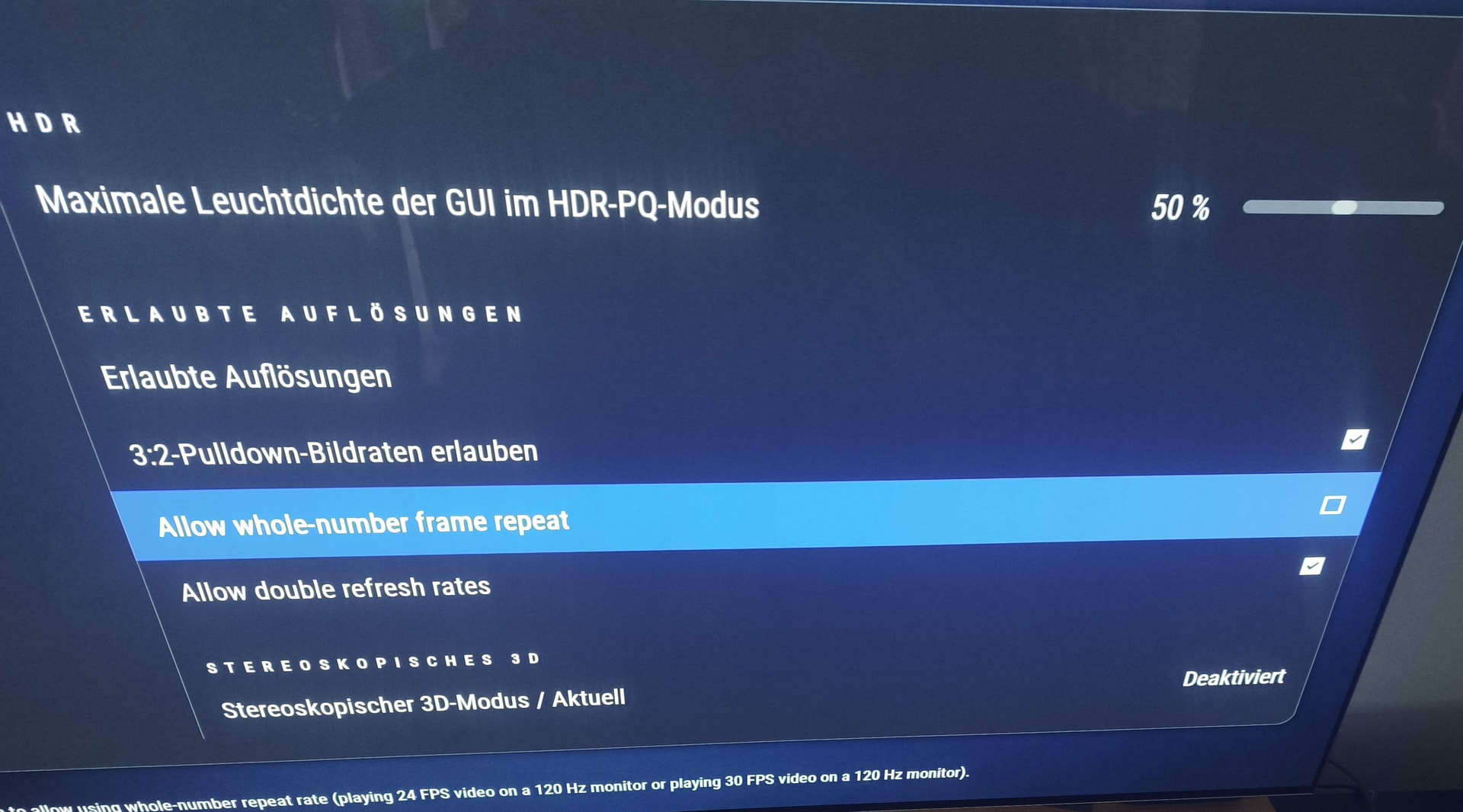

Hi BigMike66, my issue sounds similar, it also broke with 20260725, so the same version. Only difference is, I have a solid black instead of green and nothing is shown, just sound playing. Mentioned in the other thread Amlogic-NO discussion - #3982 by jenswei .

I think I’ve found the problem.
Under System/Graphics, there’s a new setting that’s enabled by default:
“Allow whole-number frame repeat”
When I turn that off, I get the full image back :slight_smile:
It might be the same for you…
