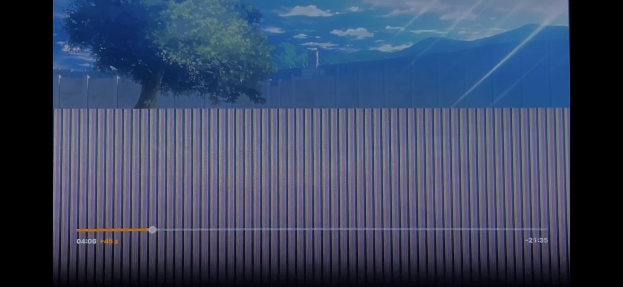

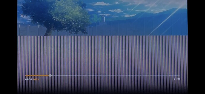

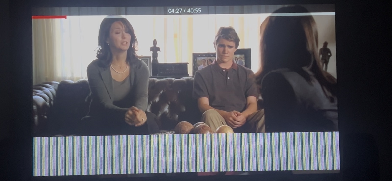

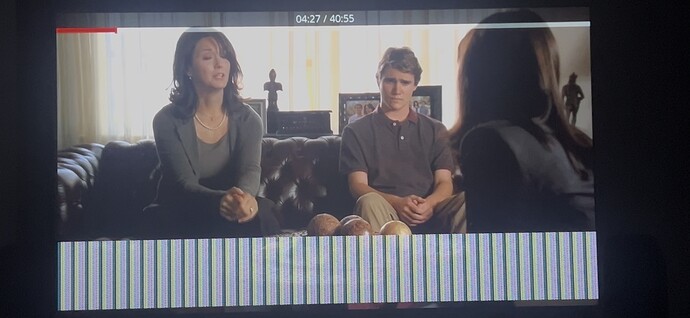

Hi,I have a strange issue when I skip forward/back in HEVC videos… Right after the jump the new picture shows up only half done: the top part is already the right image, but the lower part is just vertical purple/grey stripes. It’s gone after a split second, but it happens quite often when I press +10s / -10s a few times in a row, and it’s really annoying to watch…
My setup:
  • Ugoos AM9 Pro, CoreELEC 22.0-Piers_nightly_20260929 (had it on the 20260928 one too)
  • Kodi 22 RC1 (same on Beta 2), 4K output, Denon AVR in between
  • x265 files, 720p and 1080p anime. Happens when playing from Plex and also with a local file on the box, so it’s not a network thing.
I dug around a bit with some help:
  • the decoder doesn’t report any errors (vdec_status shows 0 errors / 0 drops)
  • it’s one decoder reset per jump, nothing weird there
  • if I set /sys/module/aml_media/parameters/debug_flag to 0x10000 (don’t keep the last frame), the stripes are gone – but then the screen goes black for a moment on every jump, which isn’t great either
  • double_write_mode=1 or fast_output_enable=0 made it worse
I filmed the TV with my phone (60 fps), the attached picture shows the frames right after a jump: stripes at 0 and 7 ms, at 23 ms the rest of the picture comes through, at 40 ms it’s clean.
Anyone else seeing this? Happy to test a build or send logs if that helps…
