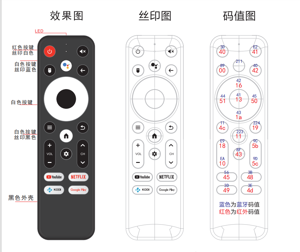

Is there an ‘remote conf.’ file for X96 M200 or x96 M300?
Someone could take some time and make it for all of us.

I’m trying to access the conf file, hopefully I’ll find it.

That remote looks just like Kinhank G1 (G10)
Try Homatics remote config,it works with G1 remote
