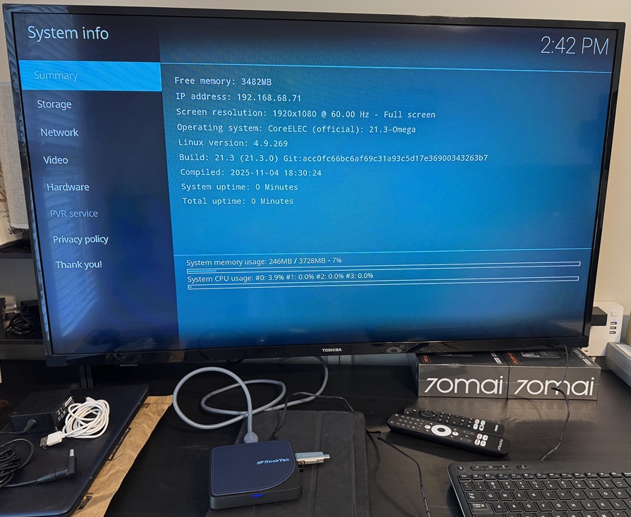

Solved the problem! … user error :blush: :sweat_smile:.
So, when I (and guessing maybe @emveepee) wrote the CE image to USB or mSD card, we used the Download Helper from the CE homepage. Well, I had assumed 21.3-Omega (Stable) was the NG image that downloaded, didn’t look, and wrote the image to USB stick. Well, it was (is) actually NE 21.3. Used the correct SEI DTB, but maybe adding dovi.ko for S905X4 from here caused the Rocktek logo boot loop?
Anyway, just manually downloaded ng.arm-21.3-Omega-Generic image, and NG installed fine. Did still loop on the Rocktek logo like 3 times, but then…
