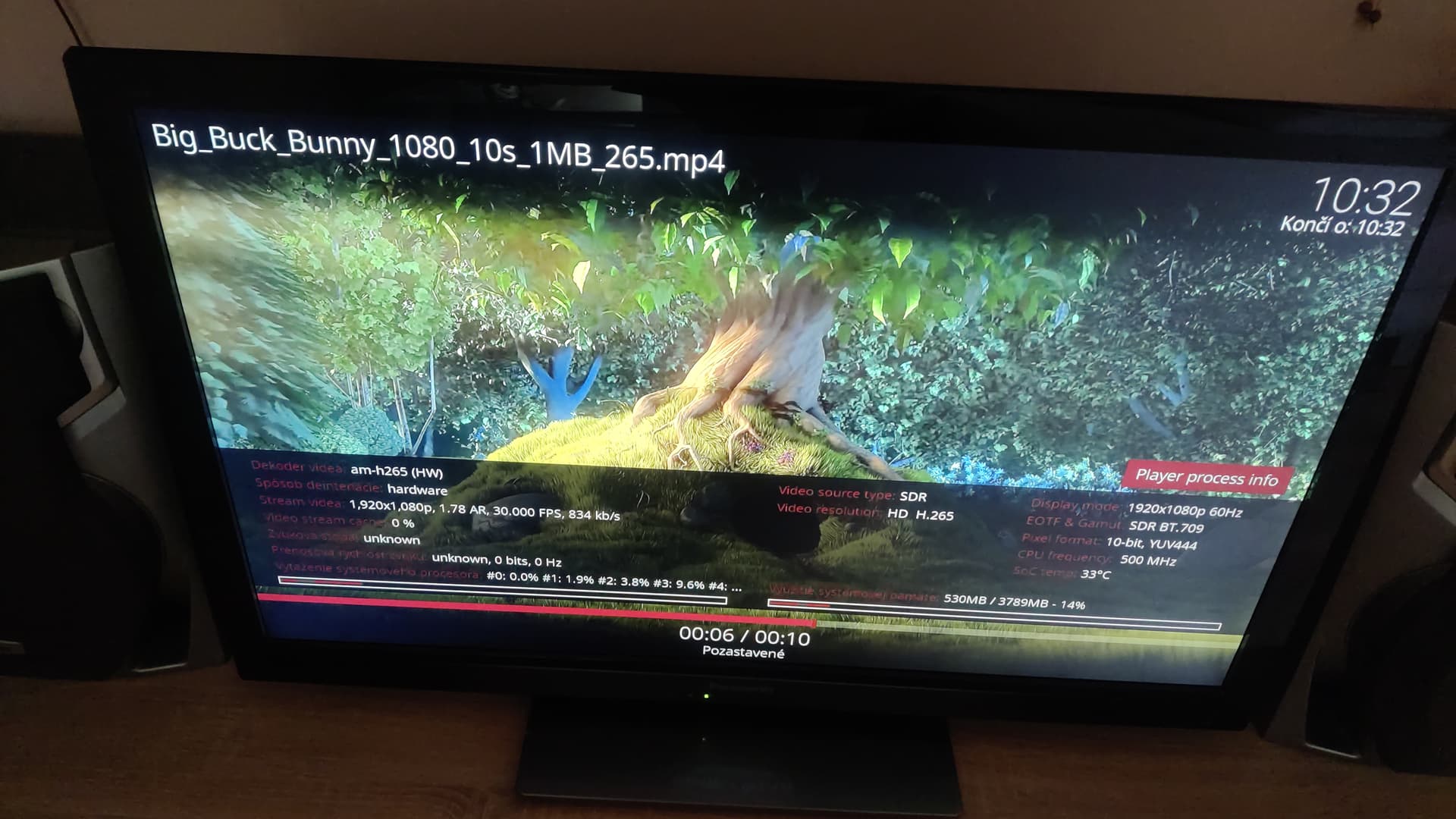

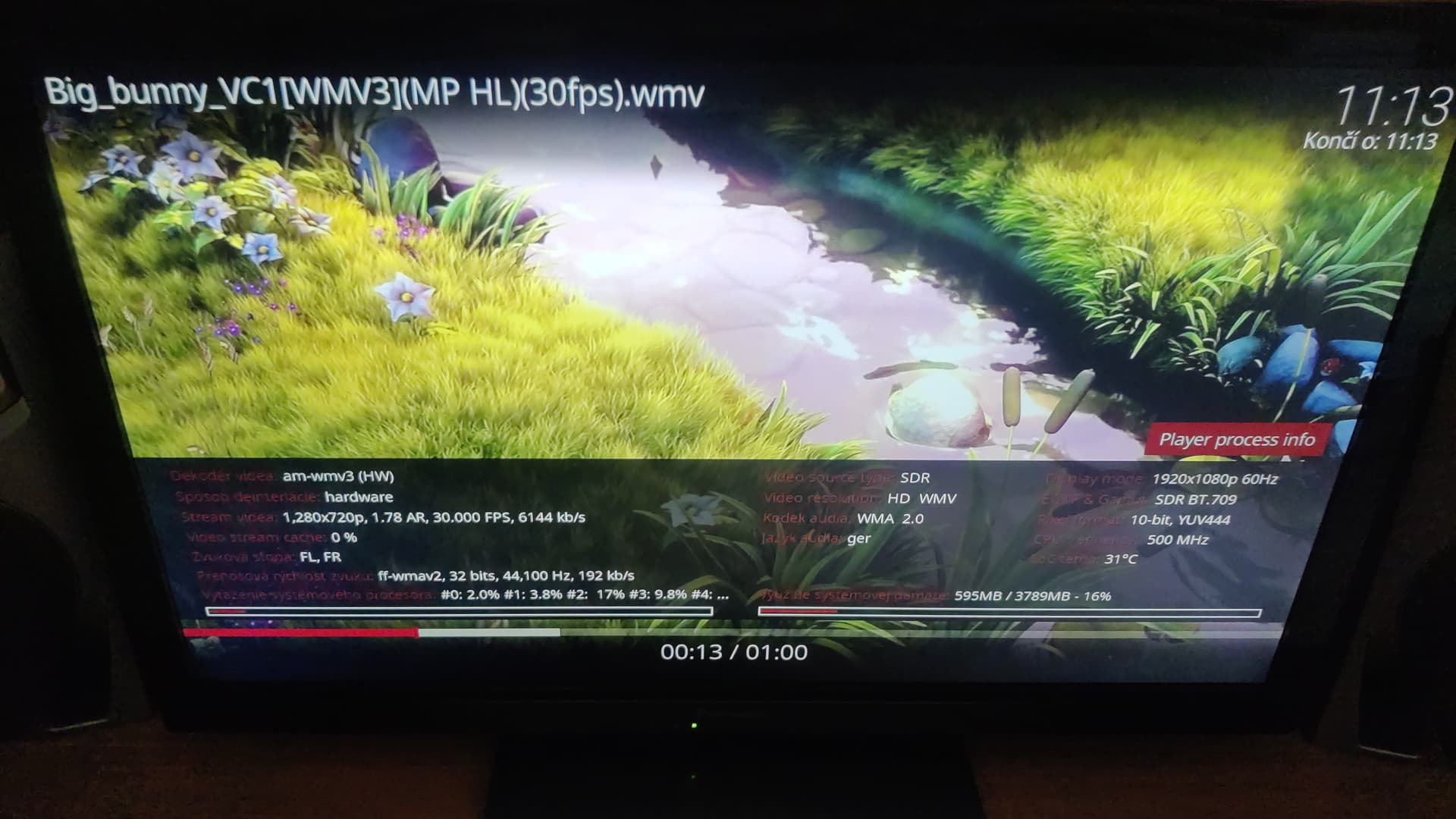

Ok, it is some bad magic for me. For testing are good these free samples: Sample Content
Taked photos with playing on last nightly build of CE22NO. (…on older kernel .119 on oldest build of CE22NO is good HW playing all these videos on my device. Only newer kernel have bug on my device. Exception are videos in mjpeg, but is other “story”. MJPEG are problematic also in android on this device: Missing support for Motion jpeg (as mjpeg or .avi) in case of s922x and maybe others amlogic processors).

Also WMV going now ok with last nightly build of CE22NO. MJPEG have issue as chosed h264.

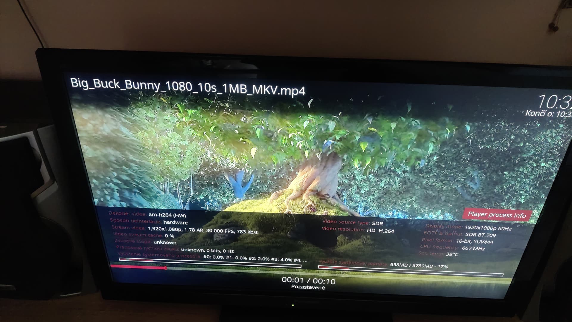

https://paste.coreelec.org/EmotionsMatter - playing of h264
https://paste.coreelec.org/ToxinsGuise - playing of mjpeg
BUN33s.mp4 - only sound, no video, no black screen
dmesg errors from playing h264 (55.6 KB) - freezing of CE screen and sound playing (1. test)
dmesg errors from playing h264.txt (49.2 KB)

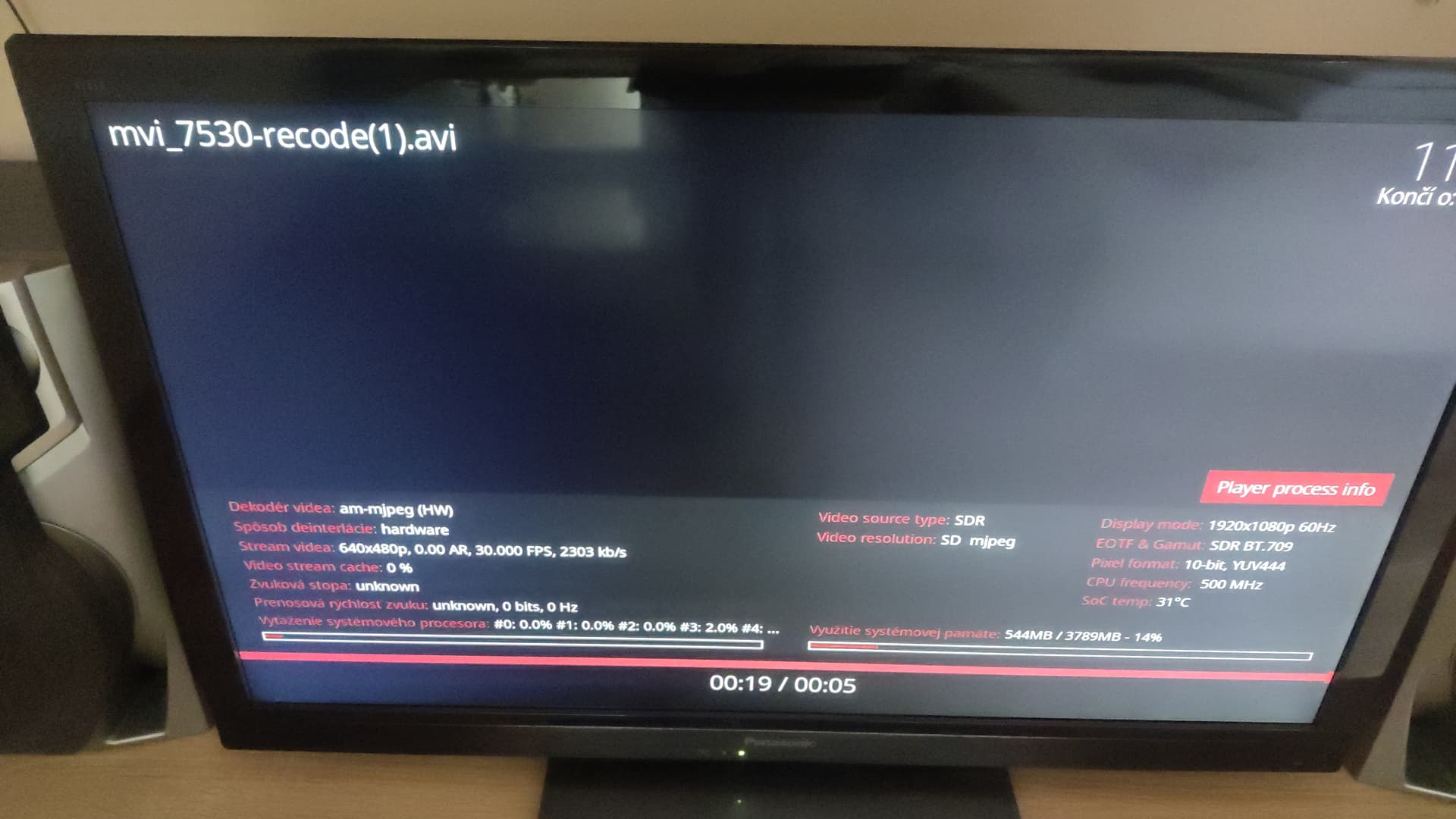

mvi_7530-recode.avi - 4 second video playing longer with black screen
dmesg errors from playing mjpeg (55.3 KB)
