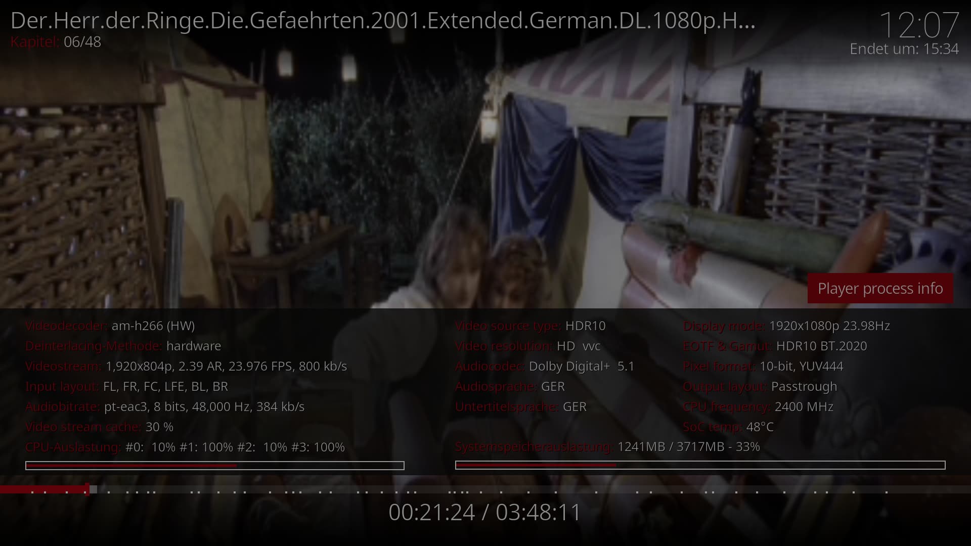

@whistler1967 is there any VVC sample what do play in HDR on Android?
The samples from dvb.org are all played in SDR, also on Android.
I tested h265 HDR and HDR10+ and both worked fine but the TS samples stay in SDR.
BTW: next nightly will have full support of VVC for MP4, MKV and TS include seeking!
No, on Android HDR is output as SDR with VVC. Unfortunately.
Thank you. Everything is working perfectly now. HDR is also not a problem with CoreELEC, just turn on SDR to HDR and everything works.
Okay, maybe I was too happy too soon with SDR to HDR, the colors are not right, the picture is too greenish
Jep can confirm here … think we have to wait for the HDR Problem being solved. ![]()
