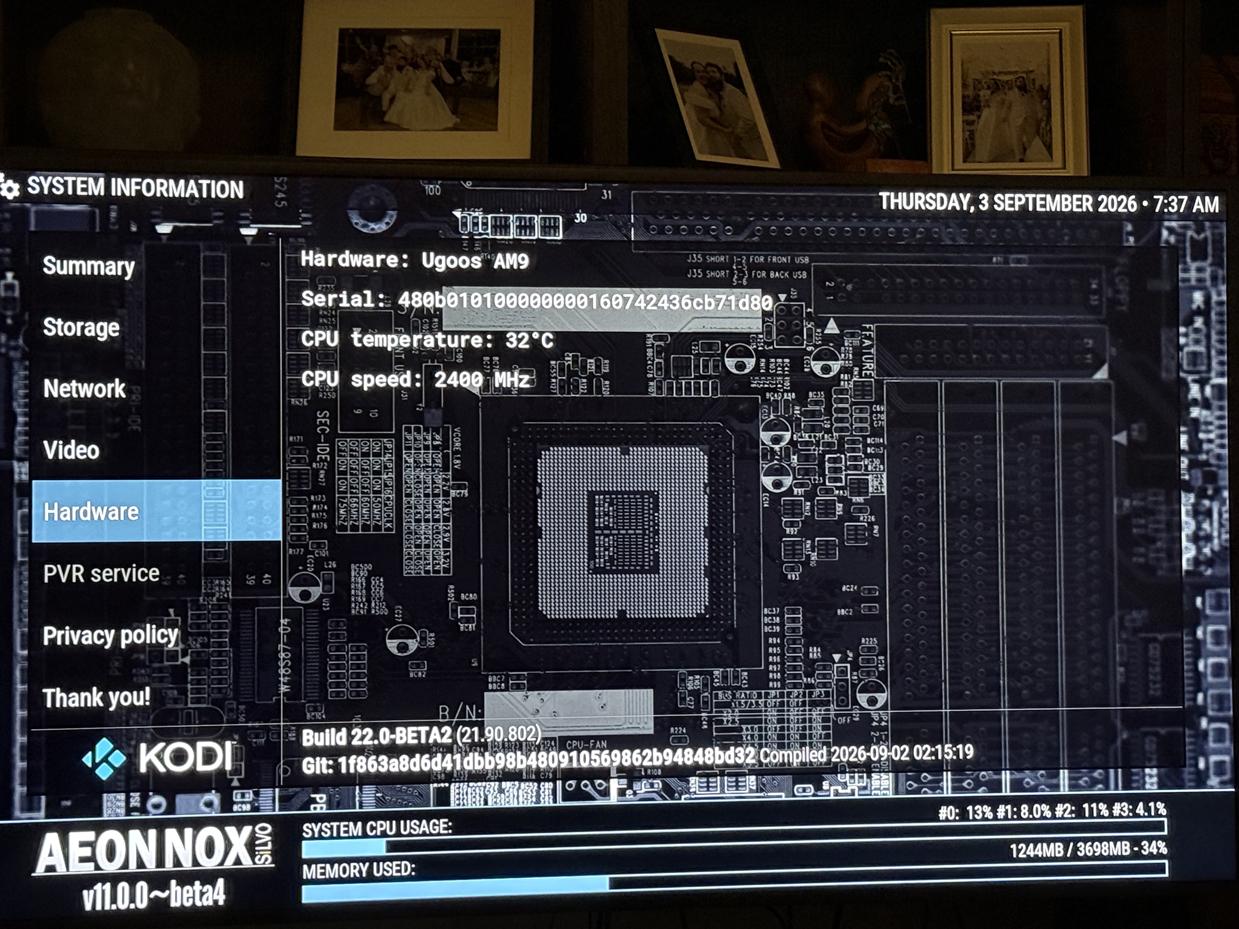

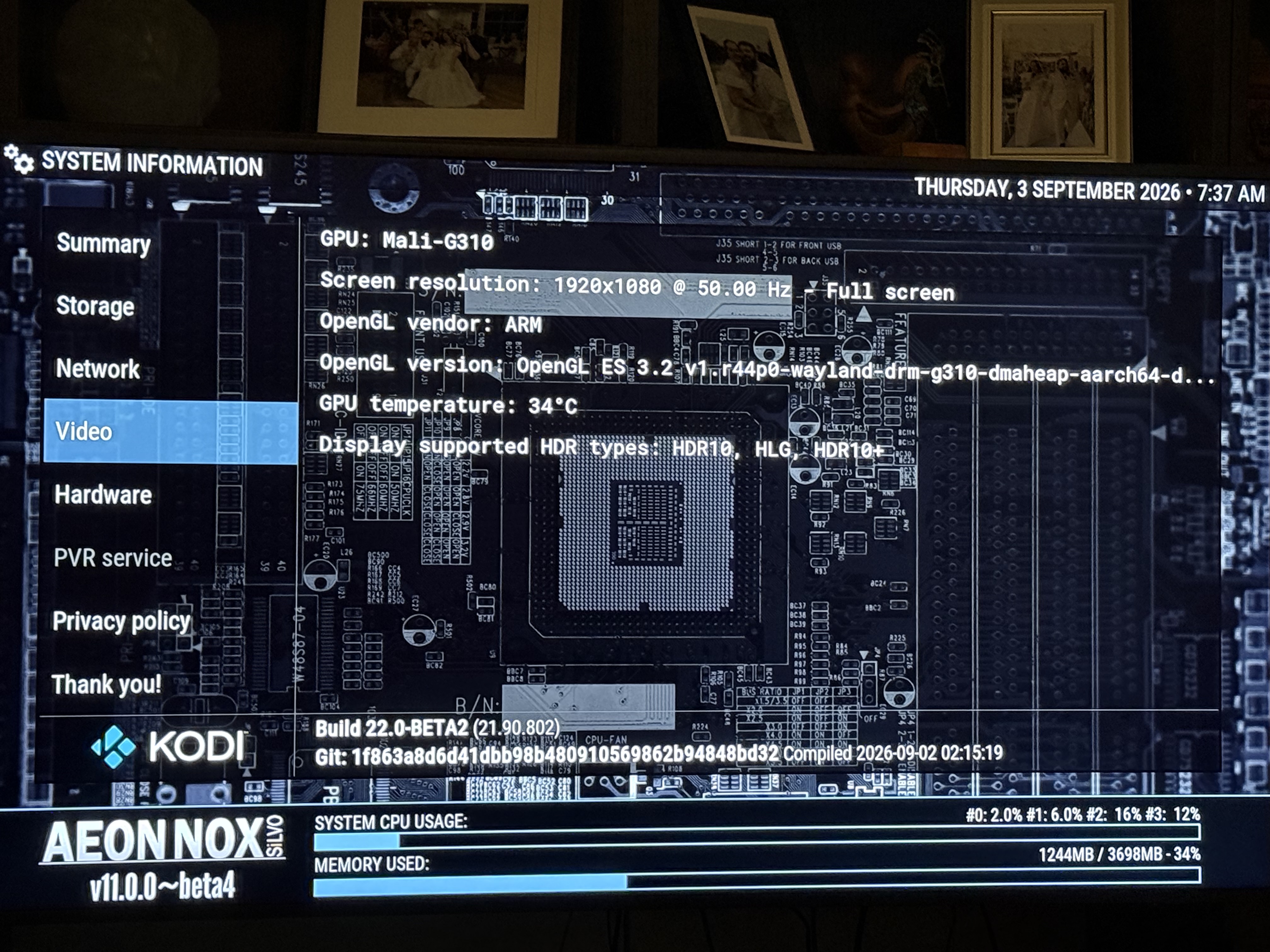

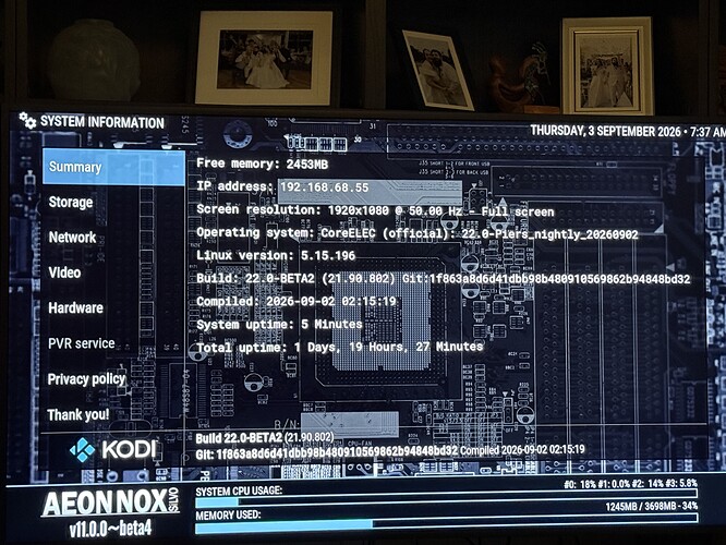

I’m currently testing the AM9 Pro with CE beta2, and photo open without any issues. I can also rotate photo clockwise using the arrow key without any problems.

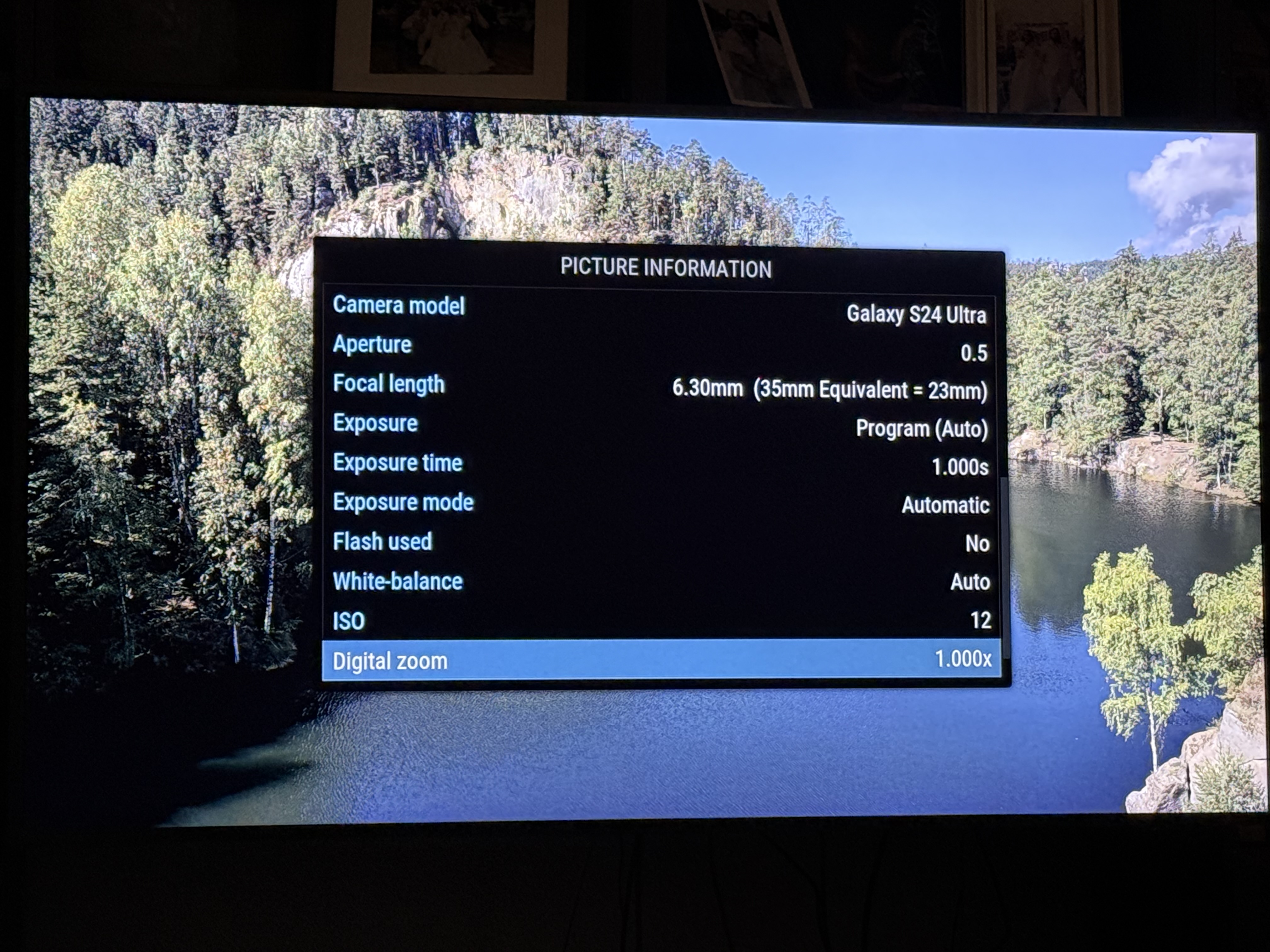

Thanks for checking but:
  1. there is no Kodi crash when those high-size pictures files (more than ~50 MB) are used in Picture Slideshow Screensaver ver.7.0.3 - I can confirm they are displayed without issues
  2. can you check on your AM9 if you can display that picture using Pictures node?

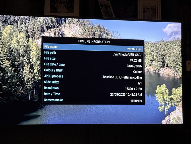

Hi I looked at your picture using file manager, in a few hours when I am back home I will use Picture node as you asked.
I tested that picture with the pictures node.
I navigated to the file location, the system didn’t have thumbnail, I clicked image to open, the screen went black for about 15sec, Kodi restarted. I used pictures node again, this time the file had a thumbnail, I was able to open without issue.
An addition to this test. I had now just updated to today’s nightly build 2026.09.04. Checked the file again, it already had thumbnail. Opened it gave an initial black screen but then the picture loaded up.
as I am typing this my screen saver has kicked in, the system isn’t happy, your picture is dimmed in the background, my pictures flash up for about 1 sec then full version of your image.
I can repeat your steps and get the same result - the image is displayed.

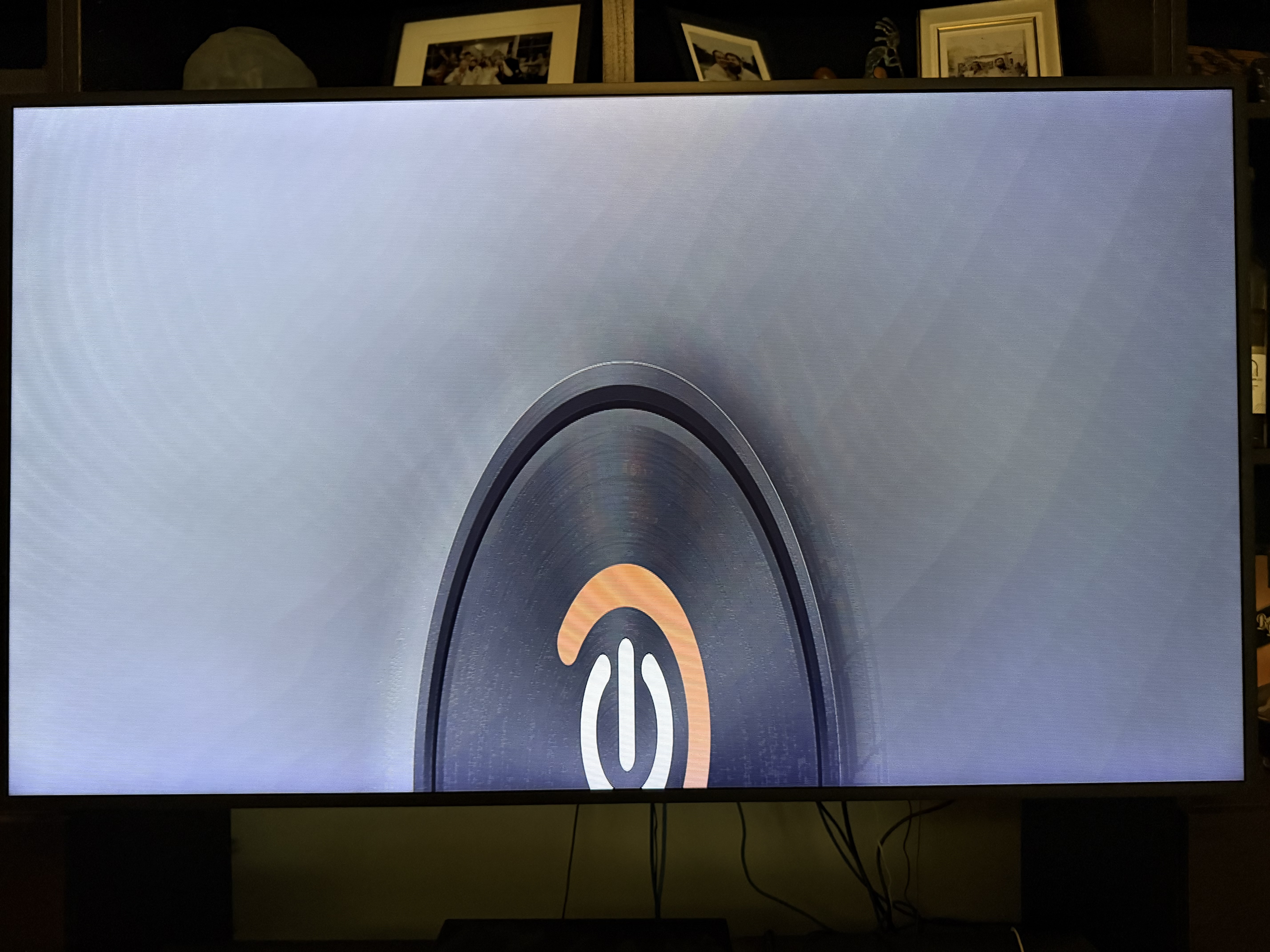

My s905x5 box is still on firmware v2.1.0, With the nightly build 20260908, V1 DTB file has done this to the screen and the system stopped here
Unable to use IR remote to turn off, probably cause the box has frozen.
Externally the V2 file is behaving the same way.
Back to the original DTB.IMG file all is good again.

result: “half” logo as on @Wildpig954 picture and then after few seconds black screen → my Ugoos AM9 is a brick now.
