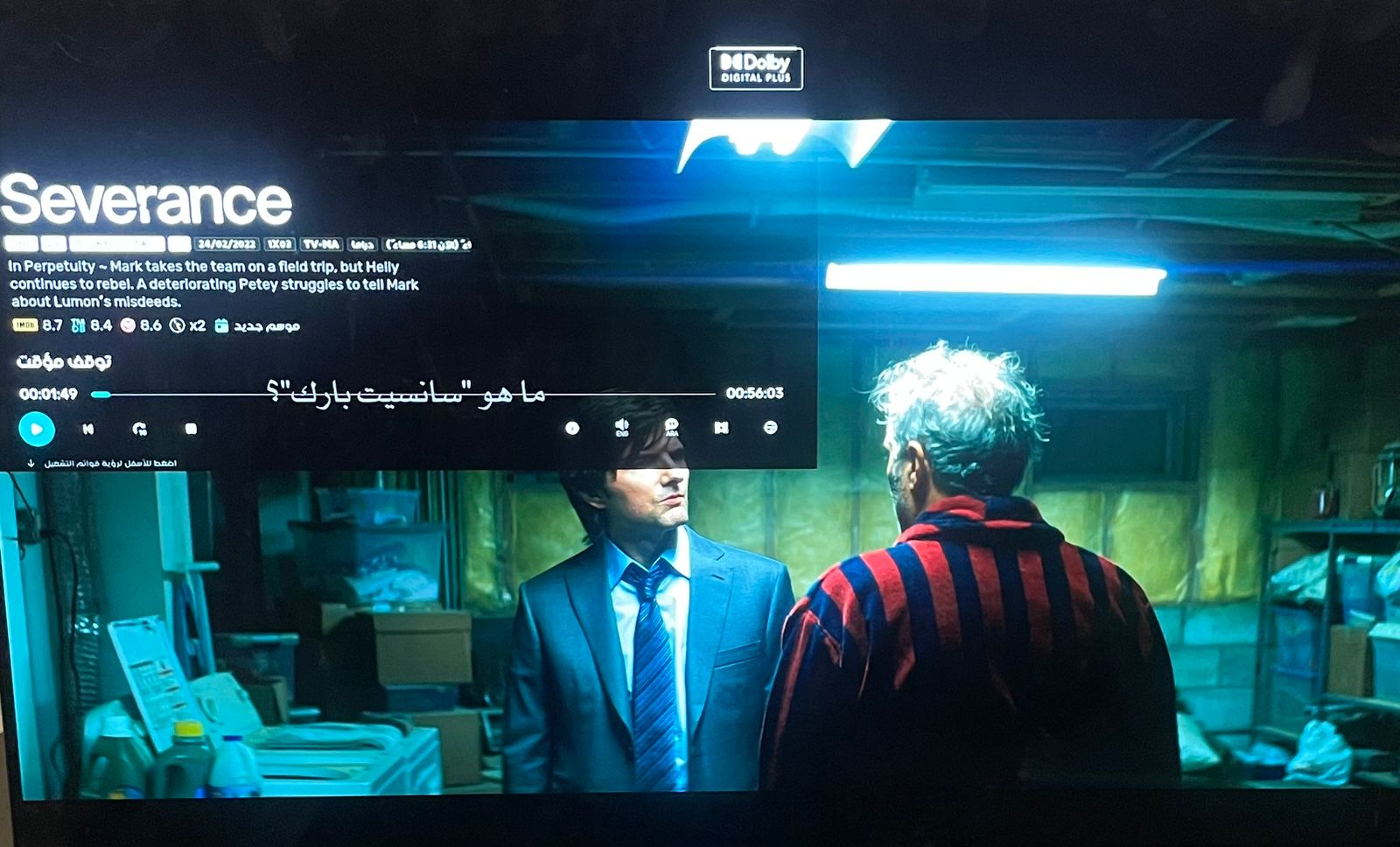

I am using the CoreELEC nightly version (nightly_20250526), and I am facing two issues:
  1. While watching movies or TV shows, the video playback size appears to be correct and fits the screen perfectly. However, the control elements (playback controls) and subtitles are displayed much smaller than expected and do not match the screen size.
  2. My UR02 remote control only works via IR and not via Bluetooth, even though it is connected to the device via Bluetooth.
Can anyone help me resolve these problems?
  1. Try changing ‘framebuffer’ to default 1920x1080 in Android settings.
