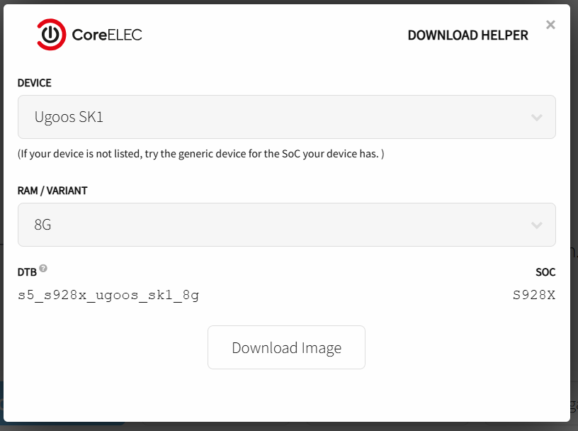

I purchased / received a SK1 yesterday and spent a bit of time playing with it.
I downloaded Coreelec from here:
and followed the instrcutions, including placing the ā€œremote.confā€ file on the root of the USB.
