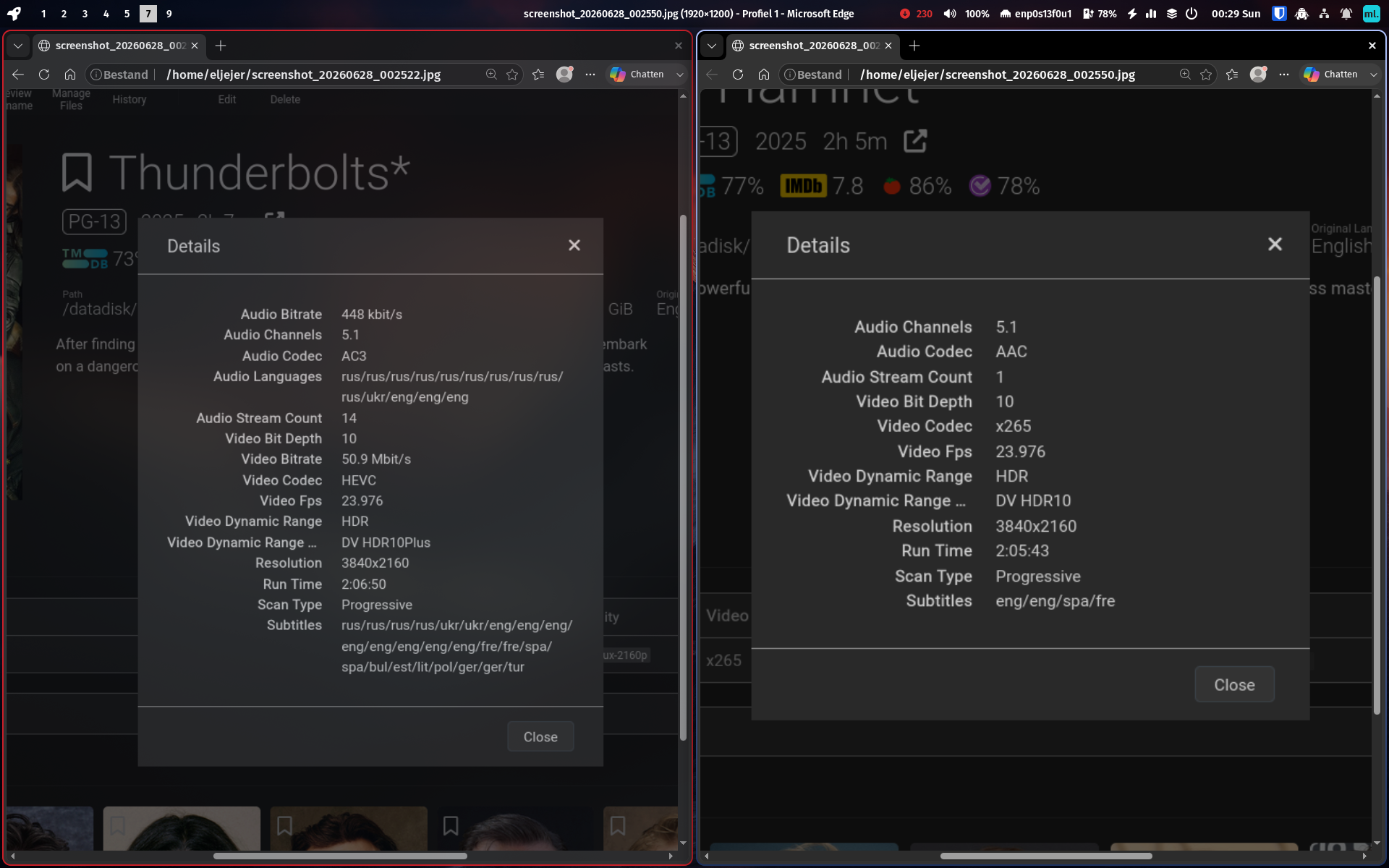

I have 2 video files both with Dolby Vision codec.
One of them behaves normally. At playback of the other one, the video controls are hidden behind the black bar on the bottom of the screen. The controls can be used only not visible. Apart from the Video Dynamic Range the specs of both video files are identical.
One has Video Dynamic Range: DV HDR10Plus
The other one has Video Dynamic Range: DV HDR10

Here’s the specs of both video files

I didn’t fully understand the content, but I guess it might be related to DV L5. Try setting L5 to 0.
