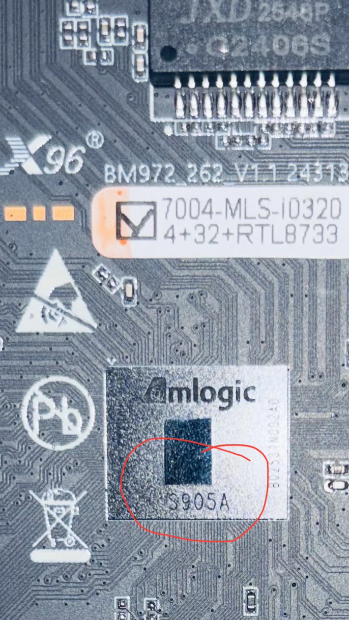

A few days ago, I received my X96 M200 to use with CoreELEC, and to my surprise, it comes with the S905A SoC instead of the S905X5M. I have been researching and testing several images, but none of them boot because they are designed for the S905X5M and not for the S905A.
I know this device is somewhat unusual, since the bootloader must be unlocked before installing any custom ROM. However, that’s not a concern for me because I was able to unlock it and install SlimBOX ATV.
Now comes my question: Has anyone managed to install a CoreELEC image on this SoC and found the corresponding DTB file?
I’m attaching some photos I took when I disassembled the device to determine exactly which SoC it uses.

The S905A and S905X5M are the same SOC for the most part. Use the s905x5m dtb. Try booting CE (latest nightly) from an SDcard if you haven’t already.
Unfortunately, I had already tried that without success. I tried the 4GB/1GB DTB, which is supposed to match the hardware specifications, but it doesn’t boot.
Should I try a different DTB instead?
As you can see above there were devices which booted fine. Maybe yours is some new revision no one knows about. Ask X96 if they made any significant changes in hw or in sw in last few months.
Maybe I should try all the DTBs for the X5 and see if any of them work.
At first, I thought it was because the bootloader was locked, but I managed to unlock it and install a custom ROM like Slimbox.
As you can see above the s7d_s905x5m_4g_1gbit is corect one.
