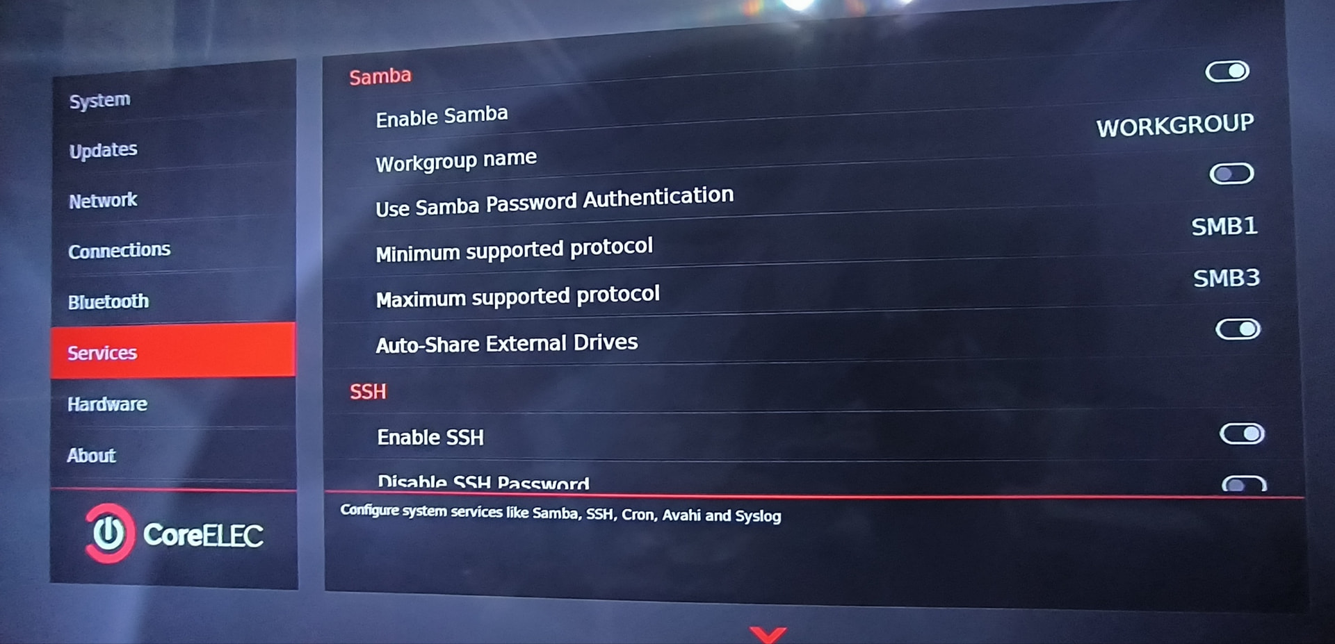

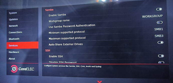

Hi have multiple CoreELEC devices on the exact same network, but only one is reachable via SSH and SMB at one time.
Box 1-wifi, box 2-wifi & box 3-ethernet
For example if all 3 is on, then box 1 is ssh/smb access, box 2 & 3 do not. I have to turn off box 1 then either box 2 or 3 ssh/smb access. So only 1 box can gave ssh/smb access at any given time.

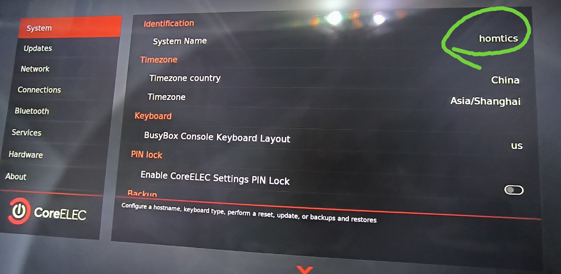

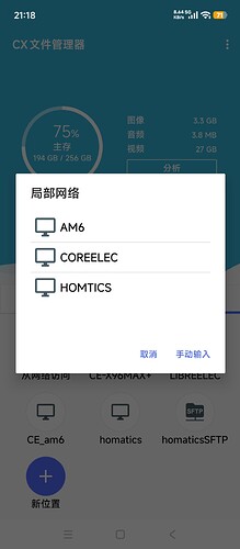

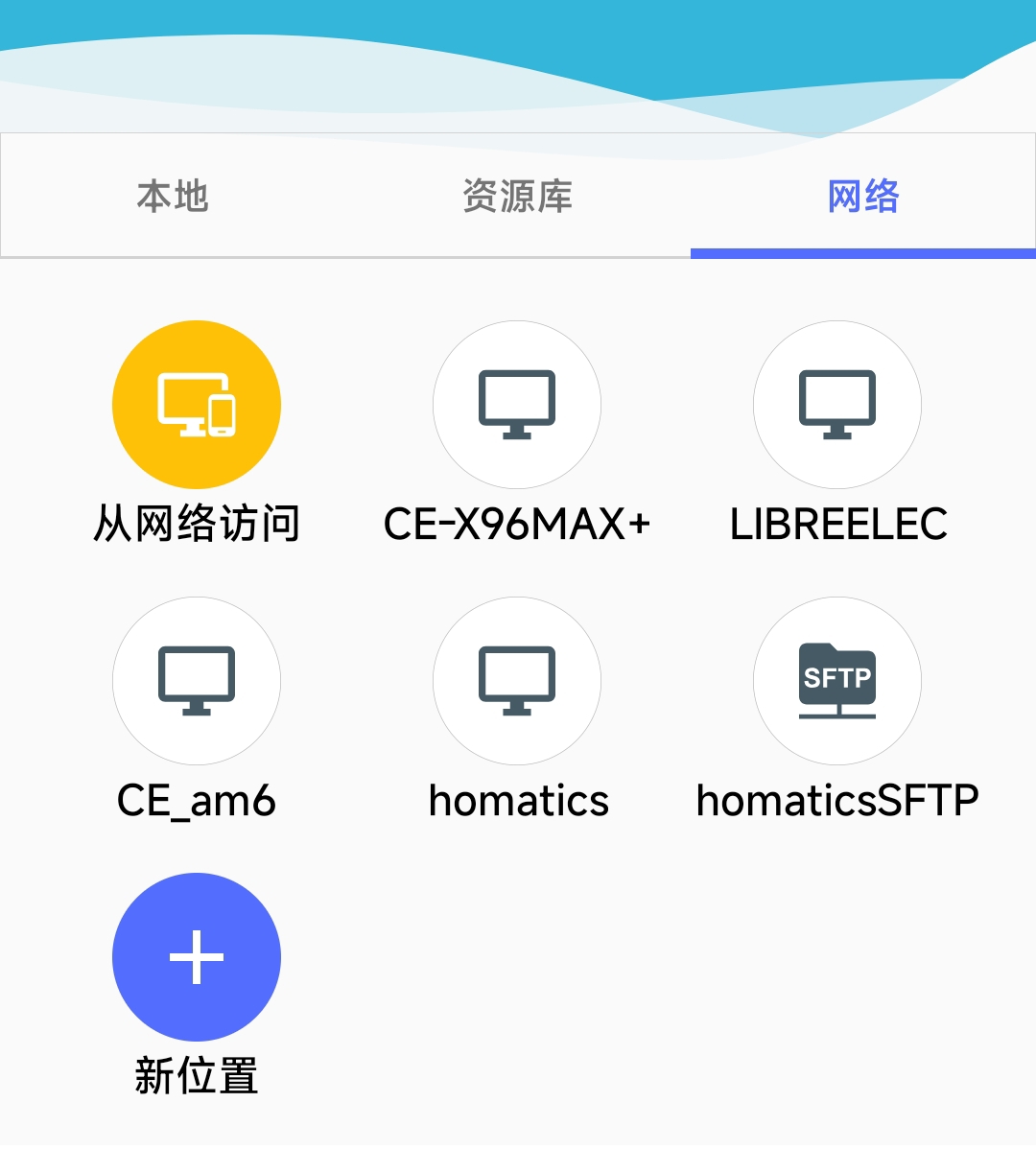

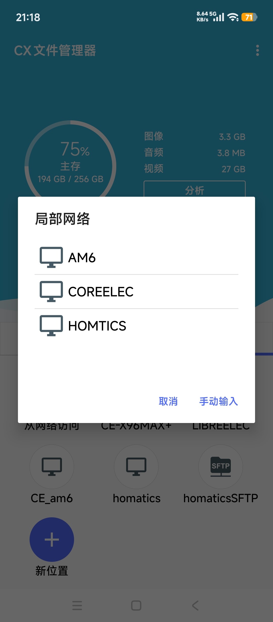

All three CE devices can connect via SMB. You can try changing the hostname box1 box2 box3
Where? I’ve already got this My network , or change in coreelec?
Thanks, I did that also. The issue is all was working before. I think it maybe tailscale, since i installed tailscale this issue started so I’m currently trying with it off.
