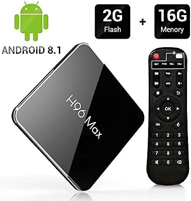

Well it has taken me some time to understand why you were so negative about my previous recommendation of the H96. It’s taken me reading of your troubles with TvHeadend to realise your H96 has the rockchip SOC. Mine has S905x2 from amlogic and therefore runs CoreELEC. I think you might be in the UK in which case your search on .zon should be H96 S905x2. Black box with H96 on the top, not multicoloured like yours. My previous comments apply and the v cheap 2/16 works fine.

Is that the correct one, i hear the wifi is cack, but ill be running wired anyway.
Right one. I’ve used WiFi when I took it on holiday. OK I. A room with a repeater. At home I use ethernet. I’ll have a play and let you know tomorrow. Only niggle is remote. Not the range or sensitivity, just that the keypresses click.
Like the rockchip I suspect, the box is awful with Android. Just goes to show how good these chaps are at team CoreELEC.
Yeah i know the remotes are cack, but this one is for the odd movie, tv probably wont get used but nice for it all to work. Even if its SD Card only it will be great for £20.

Ok well that sounds ideal at that price, if it runs CE fine and from internal then all good.
Ok well box arrived, CE installed and running very well.
Only have 2 minor issues.
1: When i turn the TV off the box goes to sleep, but when i turn it back on the box will not wake up.
Also cant get anything from the remote at all.
Its this one any idea?
Remote, read post 1 in thread H96 Max S905x2 working Coreelec.
Telly turning box off, disable CEc (system-input-peirpherals).
Turning on from remote, you’ll need to use the inject BI301 tool. Look in the guides and how to section.
I read through that already and added the remote.cfg but its not seen at all, maybe i missed something.? will read again.
I dont want to disable CEC, i want the box to turn off with the tv, but however it will not turn back on with the TV??
Yeah read about the tool, didnt see much point using that yet if i have No remote input at all.
I also tried a dual install to EMMC, It says success but then fails to boot with a cannout mout file system or something, so just removed it, will stick to SD Card.
Only thing I can comment on is your last para. You really don’t miss out on much by running from SD. I did a full install to EMMC on 2/16 before answering you but successfully did a dual boot on my 4/32 previously.
Good luck with the remote. You must have missed something because it’s defo the one I’ve used on both boxes.You did unzip the file you downloaded?
Yeah SD is fine with me, its pretty fast anyway.
Just tried it again and Bang its working, and yes i did unzip it hehe.
Just the same weird wakeup issue, Red button turns box off, literally off not suspend .
