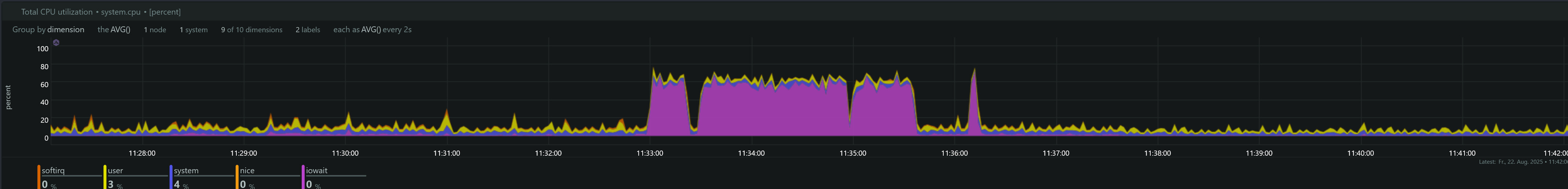

At the exact same time I had I/O-wait on my server (see below). But again: This only happens when using this player!

Given that I also have I/O wait on the server when it happens I guess it’s a hardware issue then. Just strange it seems that its only happening with my Ugoos.
