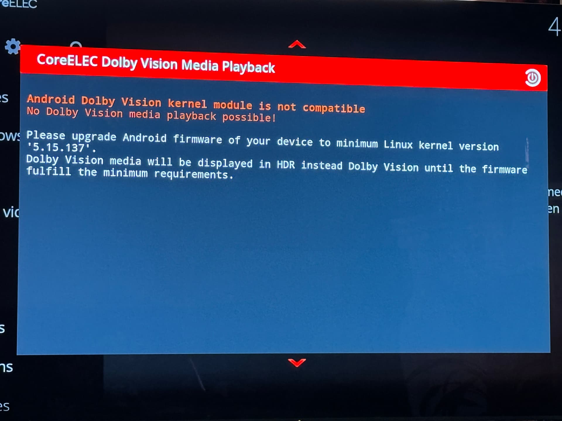

I also tried 22 NO but coreelec does not play DV. It is asking for Kernel 5.15 and android does not seem to have 5.15 for Ugoos
Nope, different chipset : S922X-J (amb6+) : S905X4 (Dune).
I didn’t see this message on Dune but because kernel was 5.15 surely, even if I think CoreELEC has his own kernel but not fully understand at 100% all of it lol :slight_smile:
You update to 20251002 and not 20051002 right ?
For 22 NO, maybe you are using a wrong dovi.ko ? (but no clue)
No I updated from 21.2 to 20051002. check the message. Thats what i was thinking Coreelec use its own Kernel. Is there more Dovi files? Can you help me to download dovi.ko for 22 NO
You want this .ko file
Keep in mind that you lose Profile 7 FEL ,all other Dolby Vision playback is Excellent!!
With VS Engine for tone mapping!!
Hi, I would like to have this Dovi.ko file. For now I have dovi for NG one. But you Mentioned its the same for CE-22. I do not mind loosing FEL. I dont have many movies in FEL though. I copied NG dovi.ko in CE-22 but i posted error above
Thanks @freddy it works
