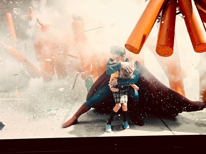

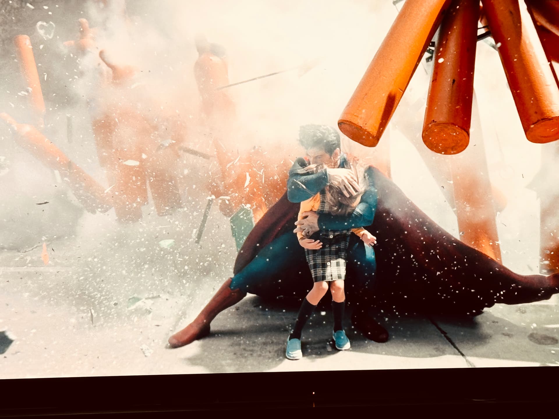

I did not notice anny issue other than too golden (warm) picture. Atmos effects very vivid thats nice.
May be i have to install again and check if it can fix picture colors for me
Can you make a screenshot of the golden (warm) picture ?
You mean āVisionā effect instead of āAtmosā, you are talking about sound or video ?
Beter properly adjust/calibrate your TV for DV picture; reinstall cannot fix āwarmā picture.
I talk about picture and sound, dolby atmos effects were good and dv , hdr and sdr too much warm. I wish to have natural color and detail

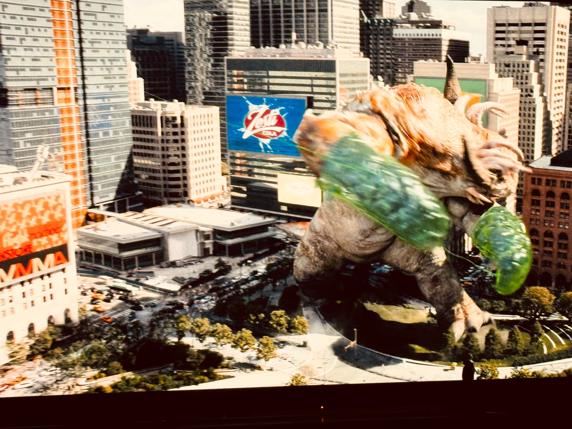

Too warm and too saturated colors
