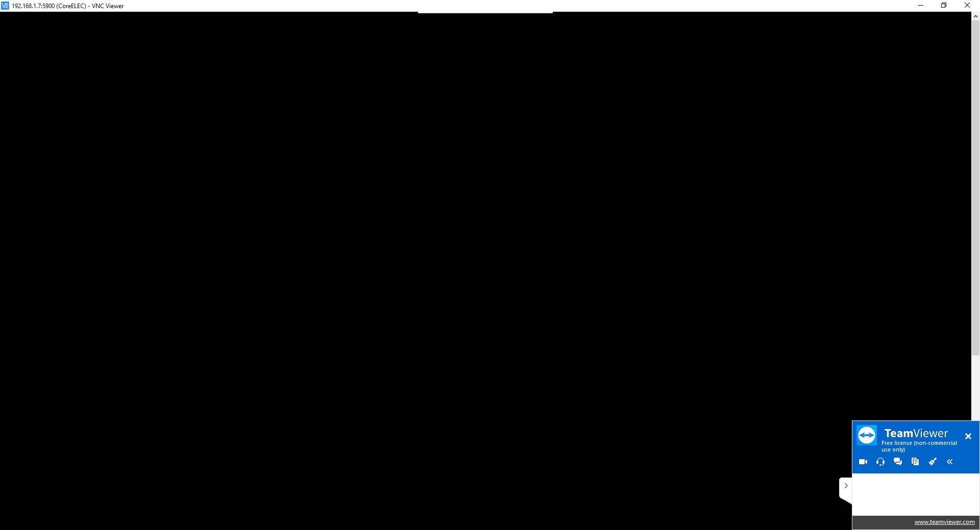

Problem: When I connect to the VNC server after boot my connection looks like this:
but if I kill the aml-vnc -P 5900 process in htop, when it auto restarts my connection looks correct:
Is it possible that the VNC addon is starting too early before the correct resolutions are being set?

I’d try removing the custom disp_cap and see how that works.
I often run my Le Potato headless and never seen anything like your first screenshot.
I have exactly the same as the first screenshot too on my S912 box.
I have tried it with no disp_cap, I get a similar problem only at a much reduced resolution in both pre and post sending the sigterm to aml-vnc
See post below, no disp_cap actually results with a blackscreen when booting headless.
I have also tried it with the full variety of resolution entries in disp_cap reported by my TV downstairs and the same as above happens.
So far the best (but broken) result is as I have described above (disp_cap with 1080p60hz but having to forse restart aml-vc).

EDIT: Reboot and back to the first screenshot again.
Yep, I get the same as you. Kill the process via htop and I get the second screenshot, reboot and it’s back to the first screenshot. How weird!!

I removed my disp_cap file (still booting headless for now as I am not home to connect to TV) and I now only get a black screen on VNC both before and after restarting the aml-vnc service.

anyone has a solution to this? On CE 19 and latest aml-vnc addon but get a black screen.
19.5+VNC Viewer works for me. Box is X96 MP S905X3.
