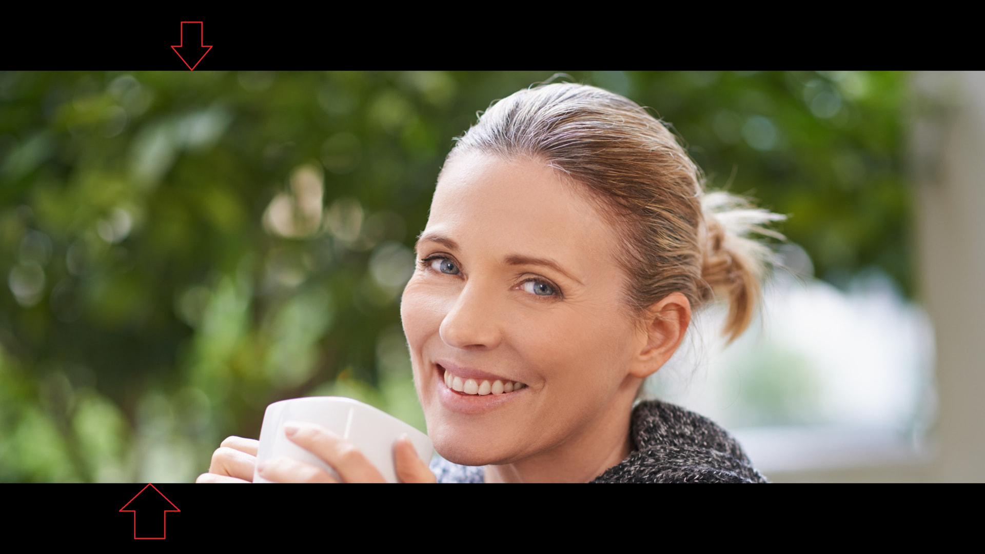

Should I test it with another TV, or is this a known bug?
Should I make changes in TV settings? Crop, ratio, etc
It is a very old 2012 Samsung TV
This is not my test photo, I’m just showing where the lines usually are
