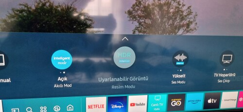

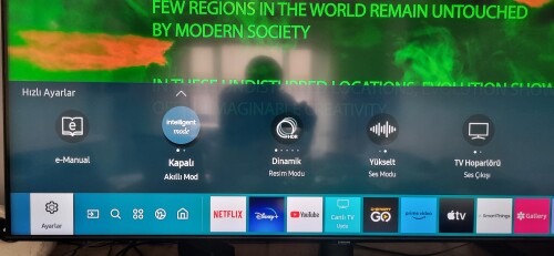

DisplayinFo on TV screen with Kernel 4.9.269 and 5.4.125
Smart mode selection and manule selection was made on Samsung TV.
My devices GT King Pro and GT King II
