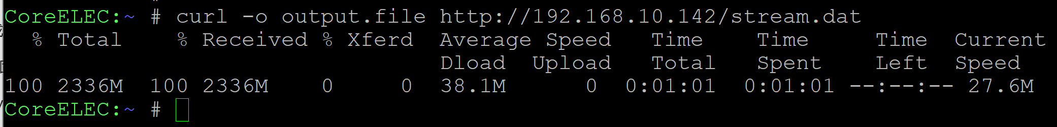

I used iperf3 test it get 1gbit,Isn’t it actually speed?How can I test actually speed.
try download any file test via wget command ssh
and see speed download
Run both client and server to test both ways.

I used Curl download file.I think the speed is limited by USB2.0, because ce runing in USB2.0 port.
