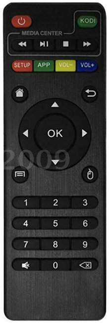

My remote looks like the photo i just uploaded.
At first boot, the remote wasn’t working, so i had to use a usb wireless mouse to start and config some settings (ssh enable for example).
I am using the attached remote.conf and it works great
remote.conf (2.7 KB)
Just copy over SSH to /storage/.config/ and reboot.

Remote config is already in config: remotes/AmRemote/X96 at master · CoreELEC/remotes · GitHub
