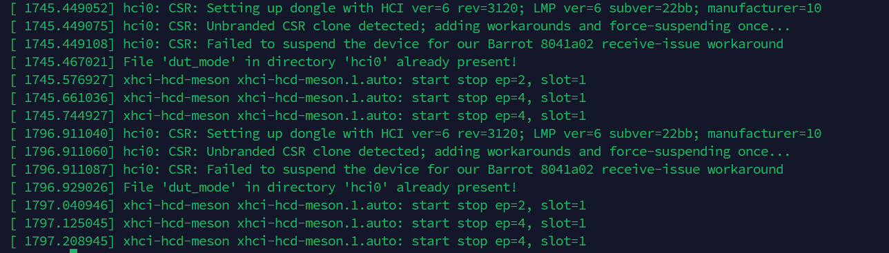

Looking at your previous logs the USB dongle uses a barrot 8041a02 chip and shows up as a fake Cambridge Silicon Radio device (it’s a CRS clone).
I don’t know if this chip is supported in CE, searching the forum there are a couple others who mention using these CSR clones and BT not working, but I didn’t see any fixes.
I’ve used a realtek 8761 (rtl8761b) USB dongle with CE. It was recognized without any additional configurations, and they can be found for ~$5.
Should have some other dongle back in work place. Will try that.
