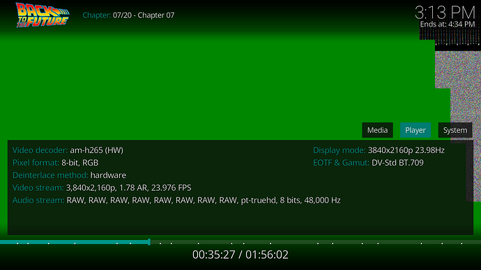

You can see that the EOTF is DV, so you configured the dovi.ko correctly.

It’s a knowing timing issue. Not sure yet how to solve it…
When it works:
kernel knows it’s DV, set display mode 0.5s after that → 8bit
When it does not work:
kernel does not know it’s DV, set display mode, kernel knows 0.5s after it’s DV → to late → 12bit
