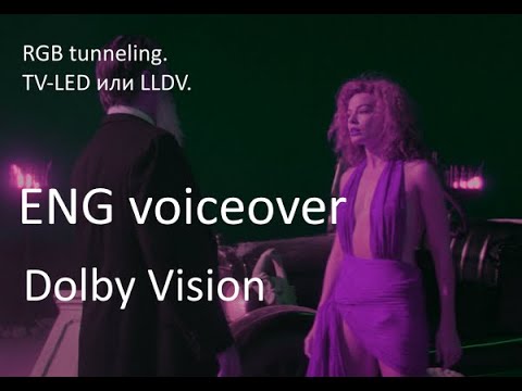

Dolby Vision TV Led not working on Panasonic GZW2004
I have installed CE21 nightly on my Ugoos AM6B+, connected to the Panasonic GZW2004 directly or through Arcam AVR31 receiver.
If i select Player Led in CE, Dolby Vision is working. If i select TV Led in CE, then i get a green/magenta ugly picture.
Can the GZW2004 really not display TV Led DV? The panasonic support line does not know which DV variants are supported,
Or is this a bug in the CE hardware detection?
dv_cap:
DolbyVision RX support list:
VSVDB Version: V2
2160p60hz: 1
Support mode:
LL_YCbCr_422_12BIT
IEEEOUI: 0x00d046
EMP: 0
VSVDB: eb0146d000440378825c7595
Yep, your TV only supports Player Led. It says LL_YCbCr_422_12BIT

Hi there , I came across with same problem:
Panasonic gz950 - soundbar- ugoos am6b+
If I enable the player led in coreelec colours are correct , with tv led I get wrong colours .
Did anyone find a fix for this ? Or is this actually expected behaviour , looks like Panasonic do not support tv led and player led needs to be enabled ?! Thanks

Also based on this:
2. Why is Dolby Vision content green and purple?
You are either missing dovi.ko or your TV does not support Display-Led Dolby Vision. Please try using Player-Led Dolby Vision.
Already had the idea was a problem with tv.
I have the GZ950. It doesn’t support TV-Led. You need to enable Player Led
