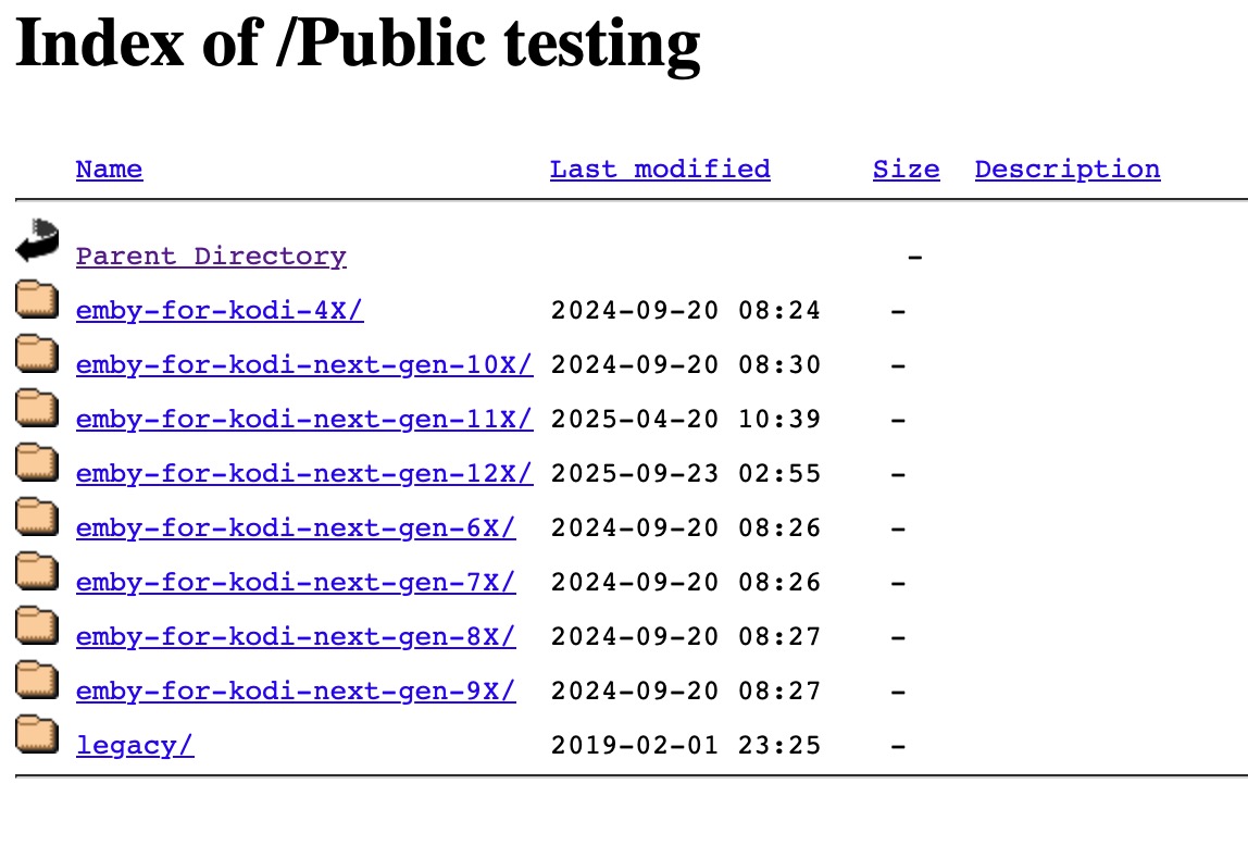

I installed the Emby plugin. During use, there are no movies in the Movies section, but there are TV shows in the TV Shows section. Did I make any setup mistakes that caused this issue? Please help, everyone. If you know the solution, please let me know. Thanks a lot! I’m using the latest beta version of the Emby plugin.
There was a similar problem with Movies not appearing in the Kodi Jellyfin addon with Kodi22. Maybe Emby needs a similar fix.
Had the same problem with newer boxes like 905X5 and X5M.
DL the newest file in public testing (back then it was build x11) which are called “next-gen” and with one of these plugins Emby works like charm.
Think the stable and the beta from the main directory are for NG builds of Kodi. But thats only a guess.
And the first scan take a looooonger time since the stable (old) one. But after that, all works fine and my S905X5 and the X5M. :v:
The x12 version is installed and working properly.
