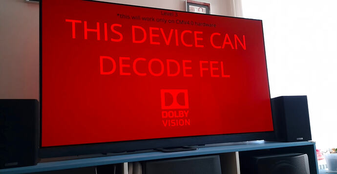

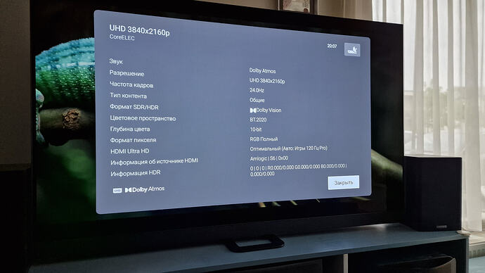

I don’t know,but CMv4.0 sign didn’t appear atleast at this moment,when playing test sample on Ugoos AM9 Pro
(This sign should appear if CMv 4.0 is present

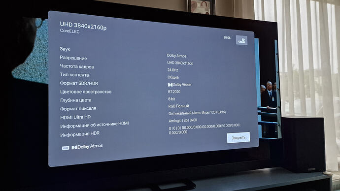

.I noticed that some DV FEL videos are output as 8bit rgb and some as 10bit rgb,but currently I have no explanation why it’s like that and if it makes any difference.
Update,probably it is always 8bit rgb,just sometimes TV makes mistake with analyzing video signal.

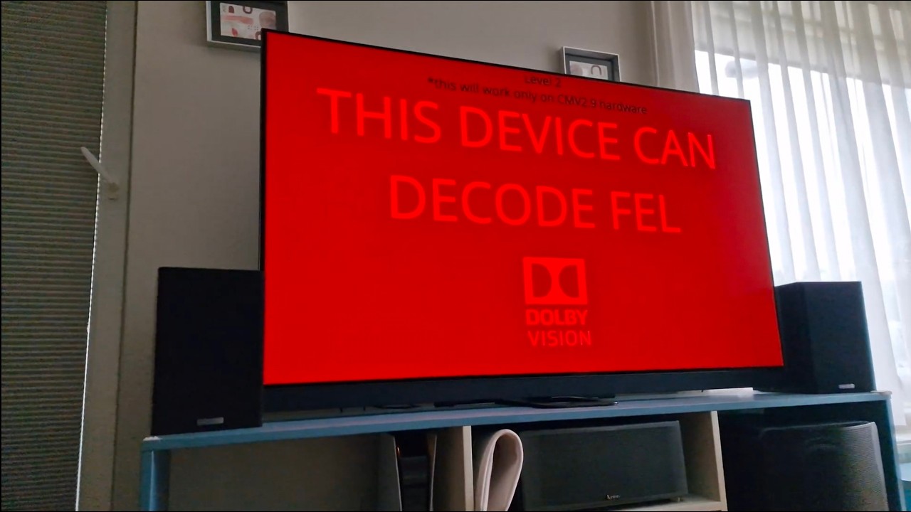

You don’t see it because you are using the V3 FEL TEST file which freezes in the exact same spot I’ve described (the issue is raised here, here, and here in this thread). You can use the V4 FEL TEST file which contains a workaround to complete the full test but the underlying issue remains as it will just freeze/exit later on in the second loop
I’m playing the V4 FEL test file on an AMB6+ into a Panny HZ980 and I’m seeing the CMv4 adjustments with player-led as well as TV-led DV. Is player-led CMv4 on the AMB6+ new? I verified the player led via the AVR, showing 12bit 422 signal.

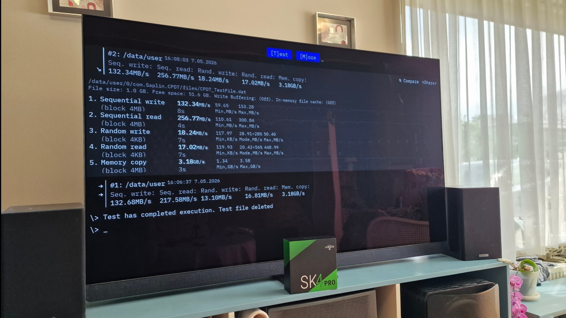

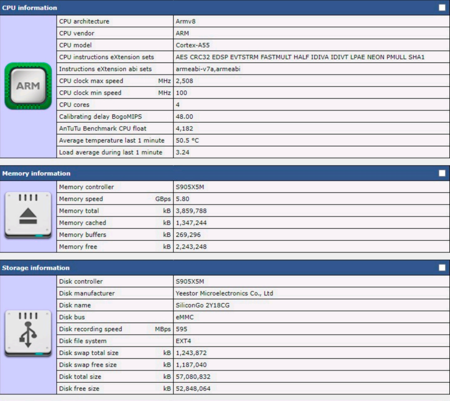

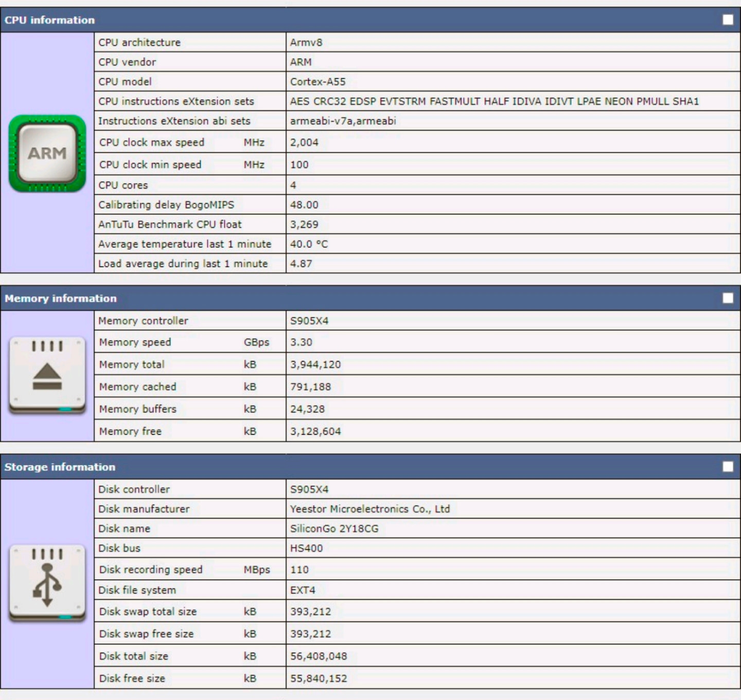

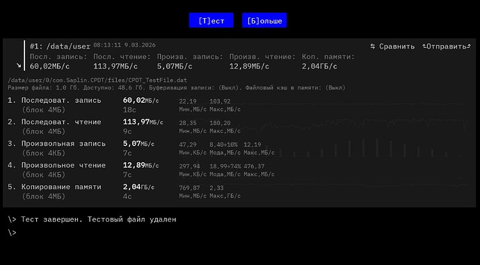

Mate you are little bit wrong,yes the new s905x5m uses same A55 cores,but does it really matter? We must compare the real world benchmarks,for example,here you go,same benchmark,s905x4 vs s905x5m,look at the antutu CPU float almost 1000 points more.
The SK4 Pro with s905x5m-K absolutely kills any s905x4 device.

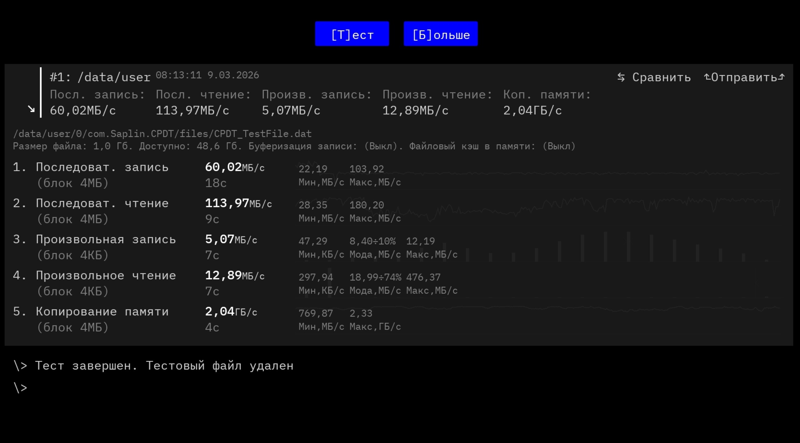

Also look at internal memory speed,CPDT benchmark s905x4 vs s905x5m:
