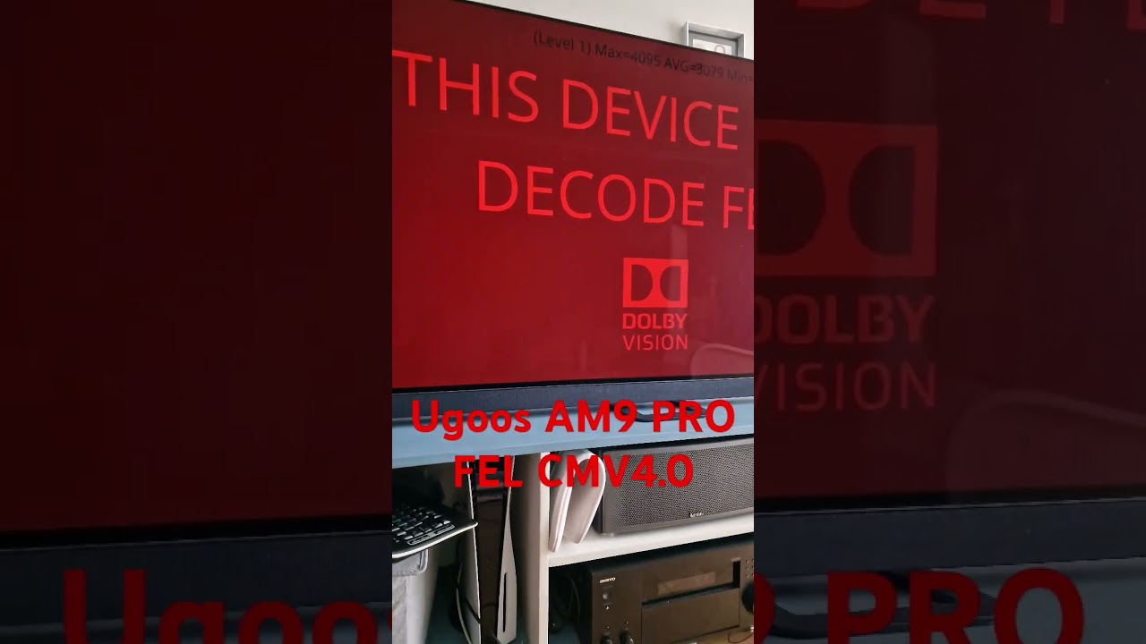

Okay,FEL works flawlessly on AM9 PRO with both CMV2.9 and CMV 4.0.

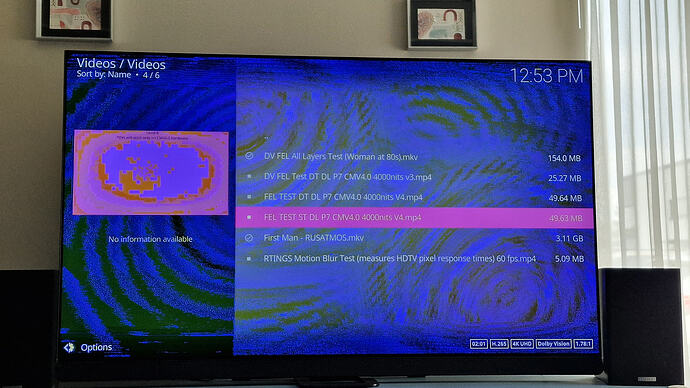

I got the issue when after CE update playing DV file triggered only black screen and in CE settings there was no DV option.
After reboot CE was pink and purple.
For me the fix was to completely shutdown AM9 PRO and reboot TV. My guess it was HDMI Edid fault,but yeah,after reboot all worked fine.
