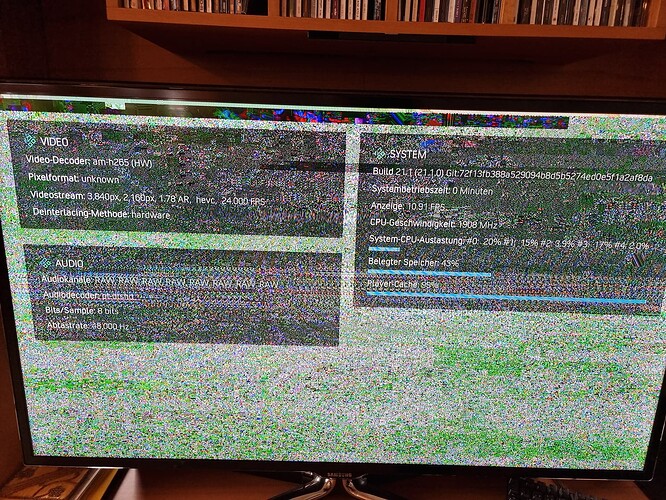

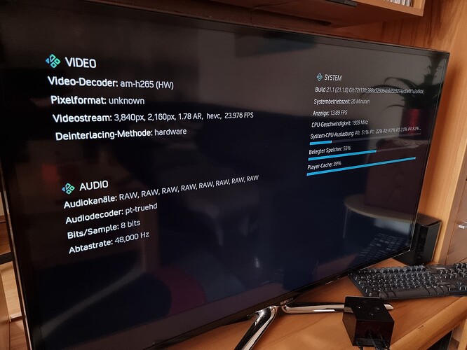

This is what 4K HEVC 422 RExt with HW Decode looks like :confused:
Log with HW Decode at 14:54: https://paste.coreelec.org/RatherImpose
With SW it works but at 4k it really does not (8fps)

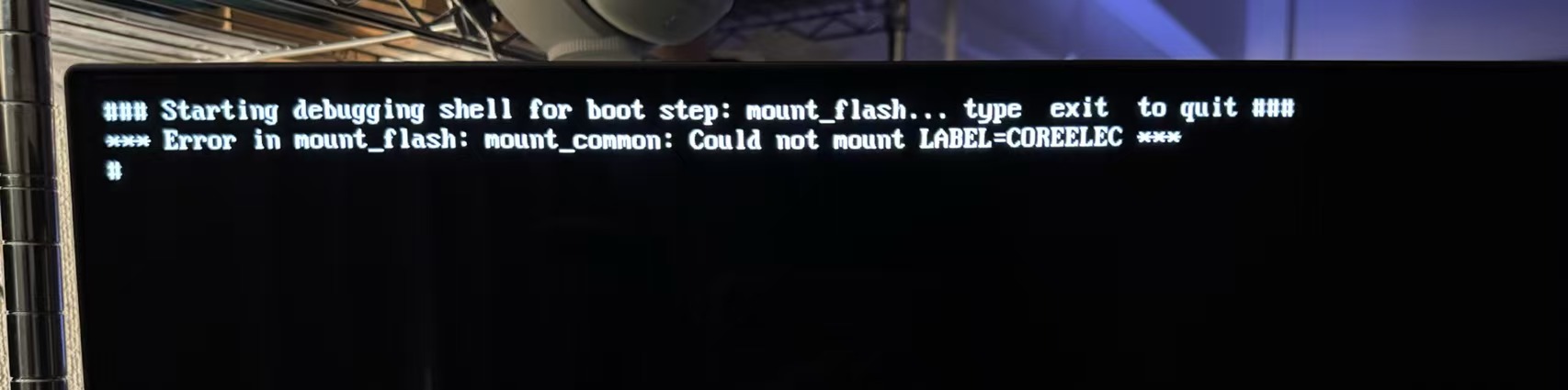

I successfully unlocked my Fire TV Cube 2nd generation (PS7212) last year and it played DV videos fine. However, a year later, I can’t mount a CE USB flash drive when I boot it up. I don’t know what the problem is. I checked the Fire TV system and it’s still the PS7212. Need I update to PS7292?
When the CE USB stick is plugged in, does it boot to FireOS or does it stop at the FireTV boot logo? Are you using a USB hub, and have you tried without it?
The FireOS version is not related, don’t worry about that.
after FireTV boot logo,
I tried with it or without a hub which succeed a year ago . Same rusult.
I also tried 3 usb flash disks. Not work.
