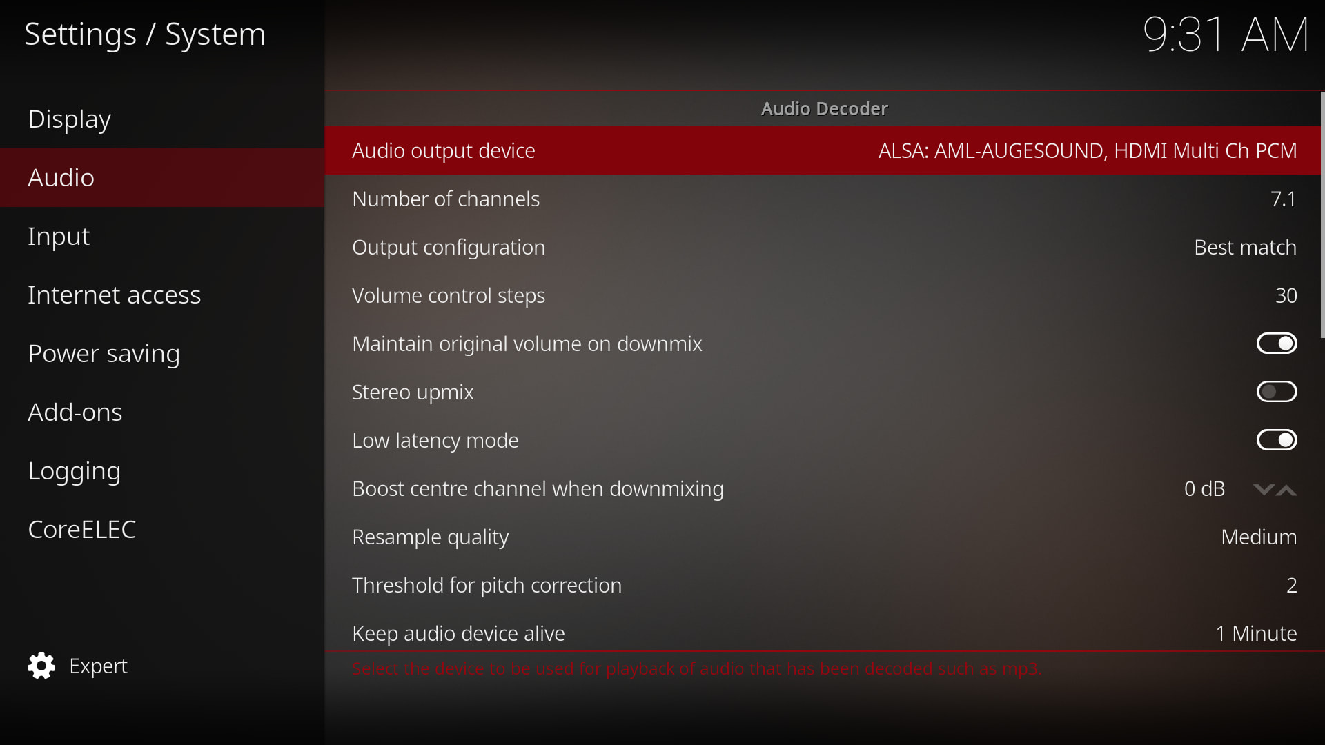

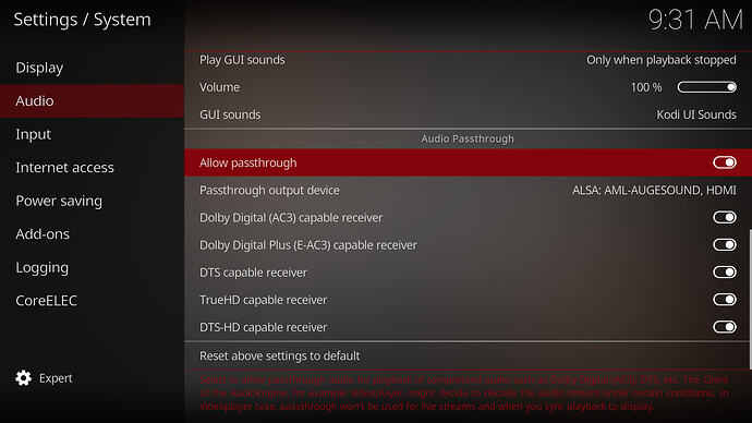

I’m hearing the audio from your sample. This is my audio setup

Hi, I have the same setup, but just noticed that under audio settings when playing the stream its defaulted to -60db and when moved up to -30 then I can hear it. Am I missing a default setting for this somewhere?

0.0dB is the default for Volume, Volume amplification, and Downmix: Center Mix Level
