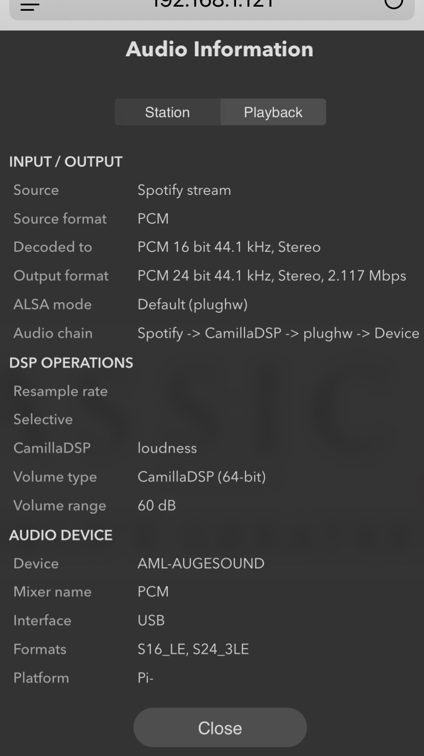

there’s an older Moode audio version (Mpd based) old arm 32bit docker install someone on the forum put together. I installed it and Surprisingly all installed and audio straight out of a homatics box 4k. Moode audio has a webserver running.Now I have doubled up renderers (eg. Spotify connect shows librespot , and one from Moode audio ). Same for AirPlay. This is ok but sometimes one works (eg. Kodi / coreelec version) then not the other. It’s a bit lucky dip which one works :joy: . I suspect they are both using same underlying ‘components’ so ‘fighting it out with each other’. Is it better to just pick one and disable one out?
Side quest was to get Moode running on homatics box 4k as dual running coreelec. Homatics is old 32bit arm I think. Although Corelec implementation is much better than Moode as displays song info and all Moode tells me is there’s a Spotify stream in the attached. Moode pumps out a webserver headless though.
