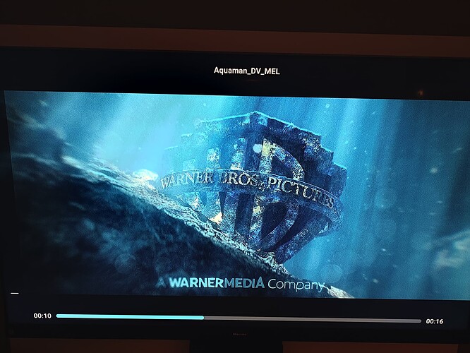

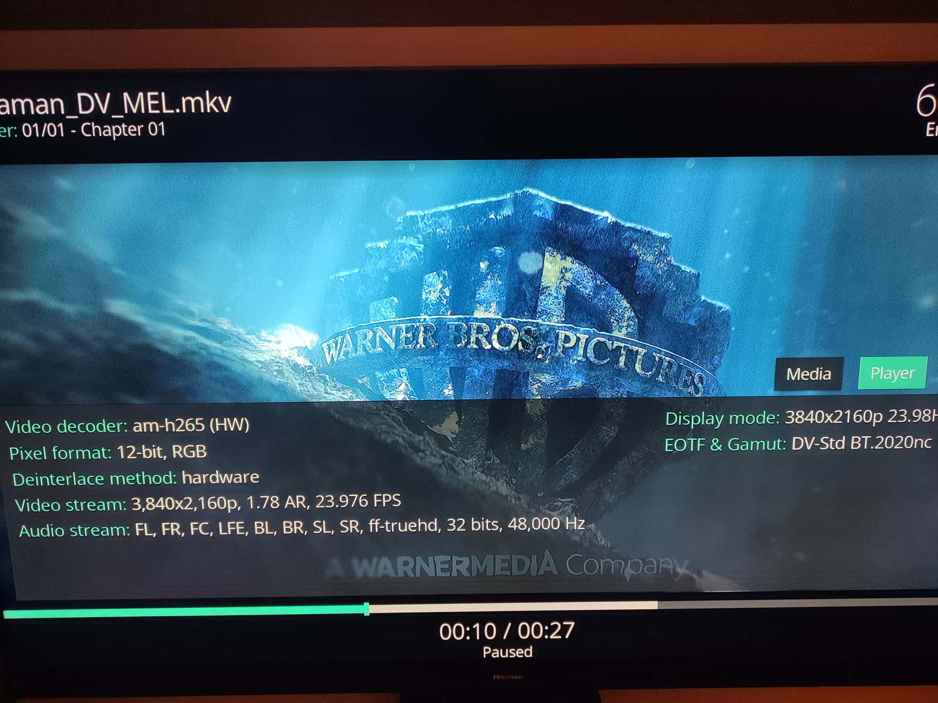

MEL just works as it ignore the EL layer. So this is same as we do right now with using libdovi to remove the EL layer. But we do it for FEL as well so we are one step further than them as you can see on this pictures with a FEL sample…
Android:
CE:
At least you can watch right now in correct colours until a new firmware fix it.
