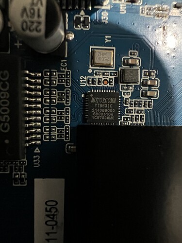

I’m having the same issue with the Dune HD box.
Please open it so we see the eth PHY chip?
Also please dump Android DTB.

Hi. Nokia 8010 user here with wired LAN issues. Wired works, but only if WiFi network is up and connected. When Wifi is disconnected, LAN drops also. Had to manually set wired LAN settings. When Wifi is connected (have to be connected before LAN) then I can ping on both addresses. Any solution around? Using sc2_s905x4_4g_1gbit as device tree. When LAN is up statistiscs for interface (ifconfig) are not changing despite there is ping ongoing and simultaneous ping to wifi does have effect on those stats.
[ 269.045518@0] meson8b-dwmac fdc00000.ethernet eth0: Link is Down
[ 329.152407@3] meson8b-dwmac fdc00000.ethernet eth0: PHY [0.0:00] driver [Generic PHY]
[ 329.203015@3] meson8b-dwmac fdc00000.ethernet eth0: No Safety Features support found
[ 329.203039@3] meson8b-dwmac fdc00000.ethernet eth0: PTP not supported by HW
[ 329.203049@3] meson8b-dwmac fdc00000.ethernet eth0: configuring for phy/rgmii link mode
[ 331.234000@3] meson8b-dwmac fdc00000.ethernet eth0: Link is Up - 1Gbps/Full - flow control rx/tx
PHY seems to be Generic (shouldn’t be there Motorcomm)? THough I ave tried with both n/a and assembled. After trying mentioned BuzzTV dtb now option to set Mtorcomm option is missing from CE config page.
