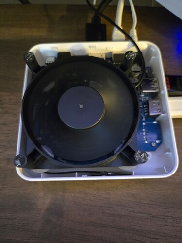

well Homatics or whatever thought it was good to make the box without any ventilation holes at all so you can put a small fan under it and get lower temps, but with no holes the fan won’t do anything so I opened it up (thankfully very easy) and put the fan inside the box lol, idle temps went down from 55 degrees celsius to 30-35.
wheres the cooling lol? (see and learn from Ugoos)
with fan “installed”
