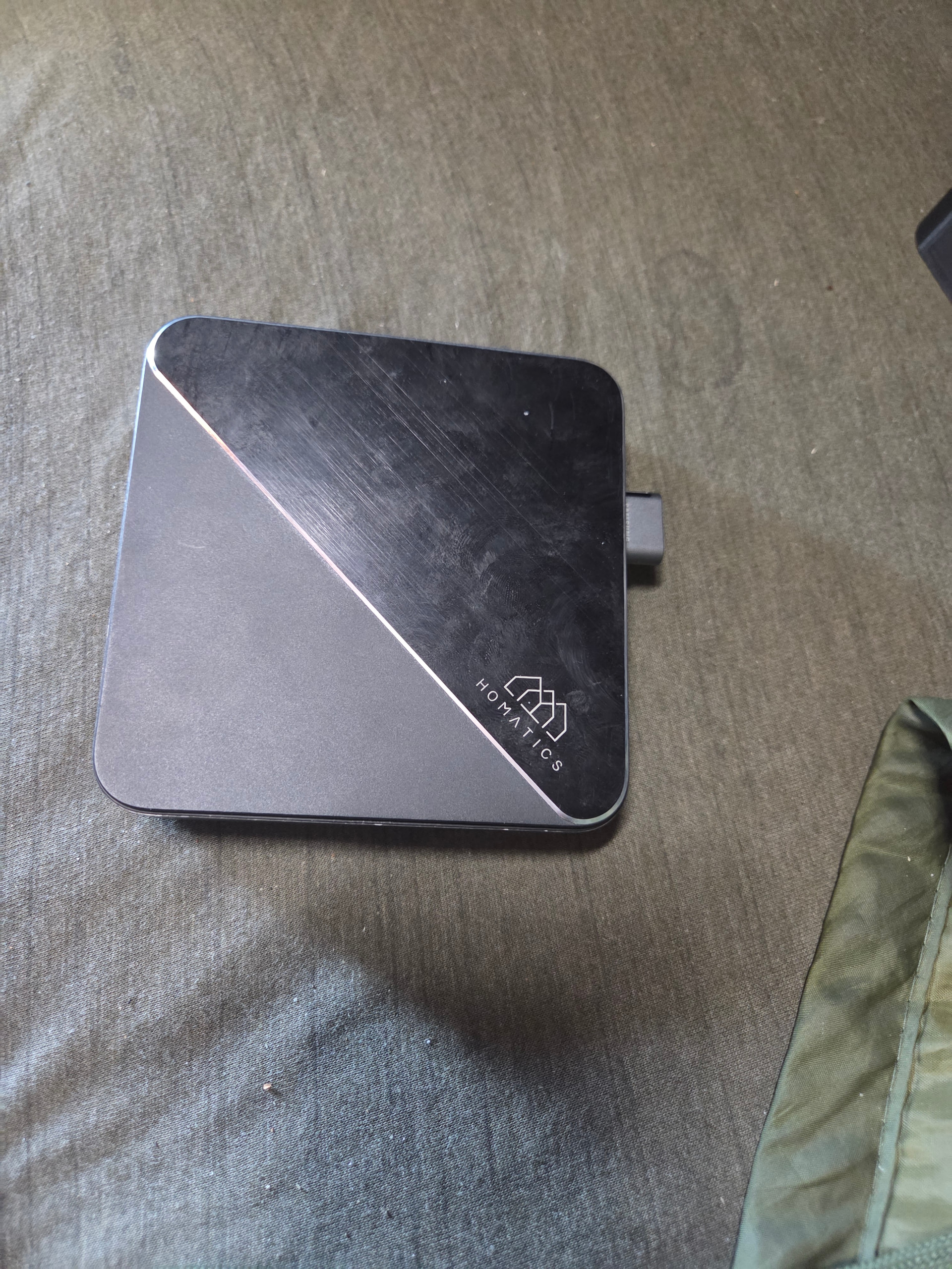

Homatics R 4k heat mod - no fan necessary

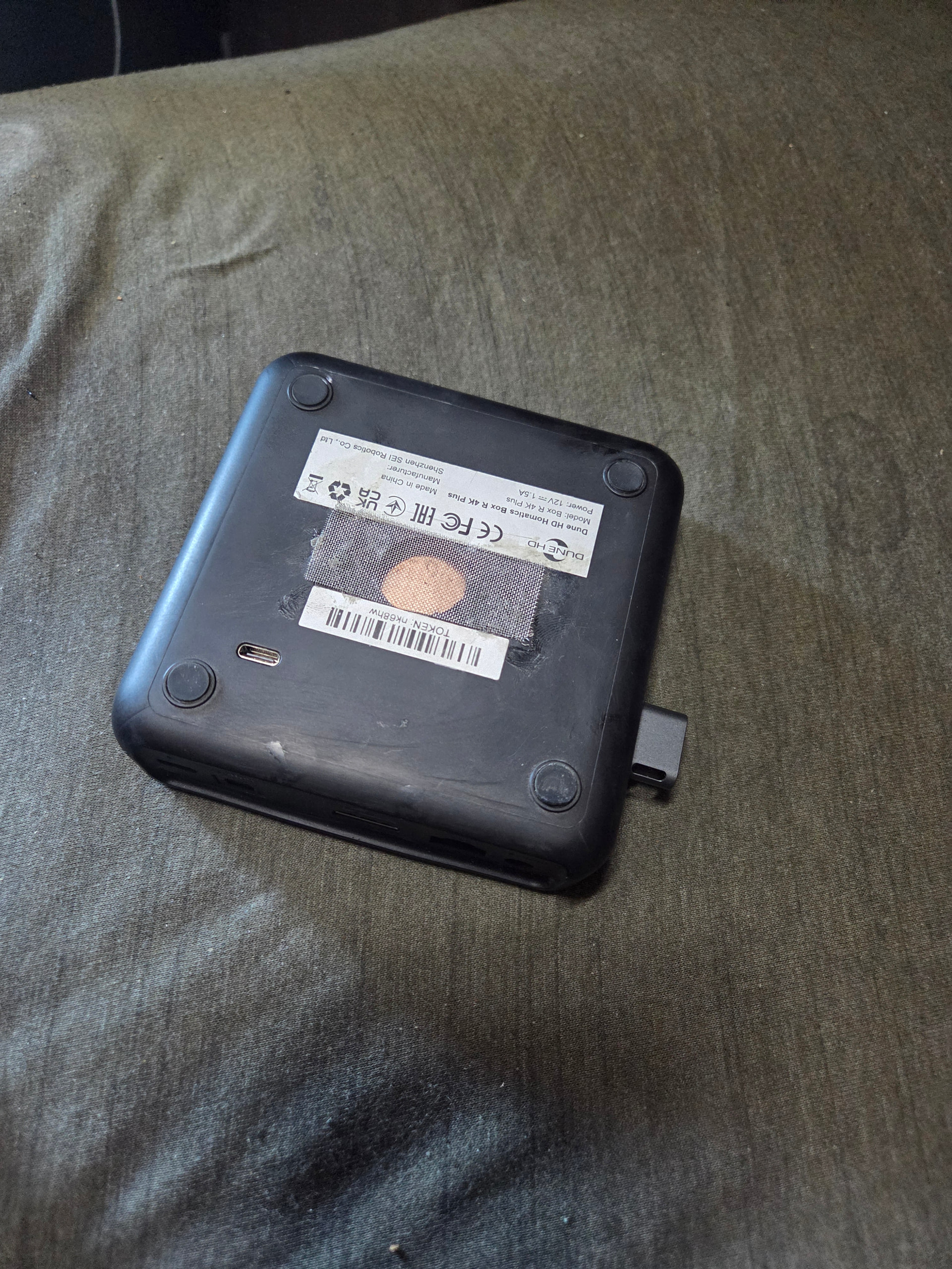

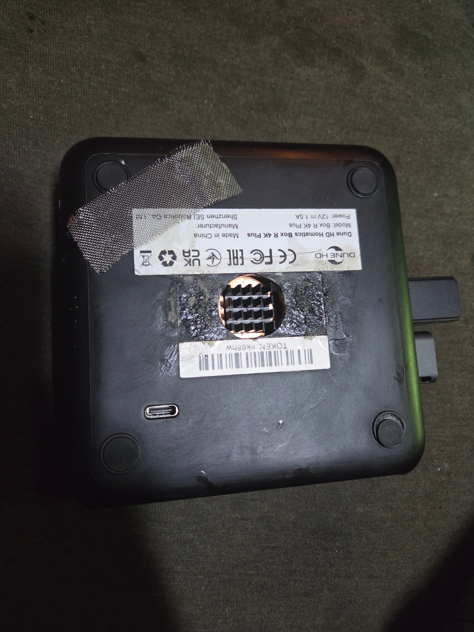

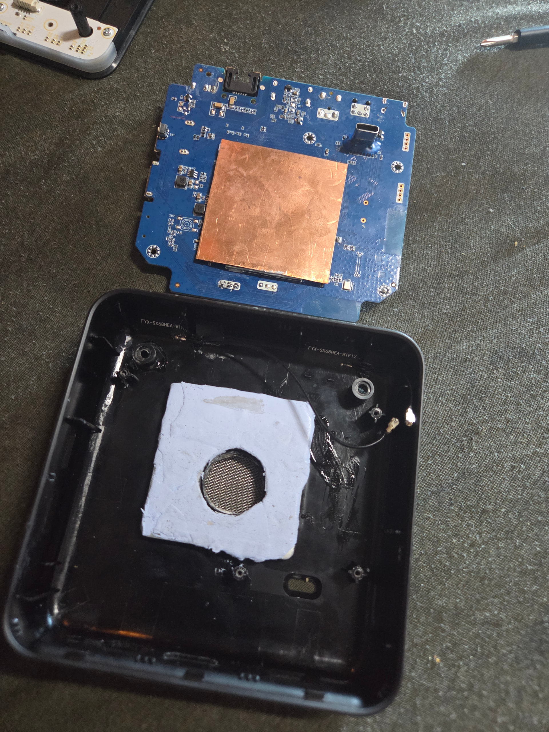

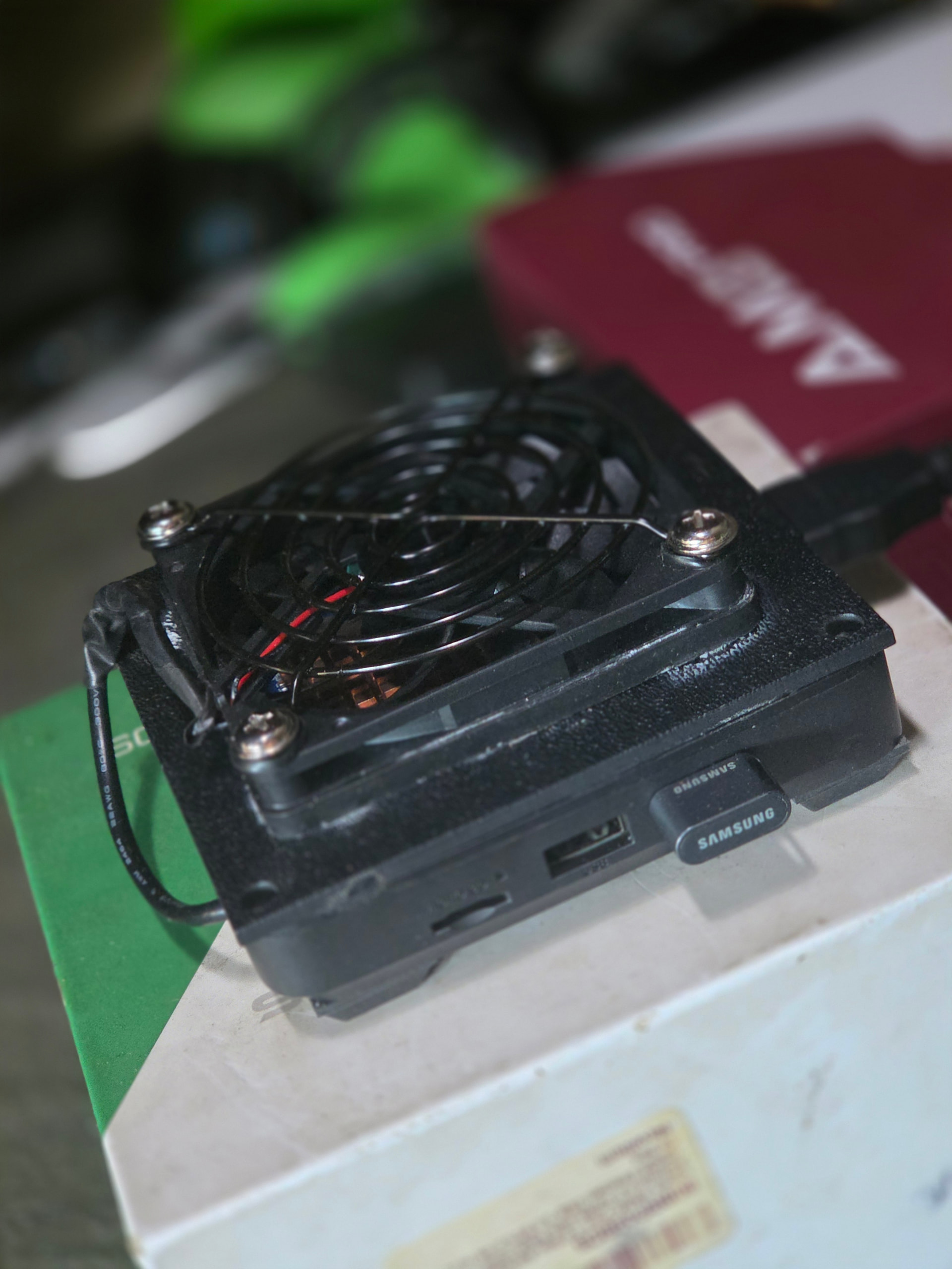

People cut a hole in the top of this box and add a fan , there is absolutely no reason to deface and destroy the beauty of this product , i can run my box next to a heater hvs10 dolby vision and installing updates maxing out cpu usage , the box will not exceed 155f no matter what I do with my current mod…

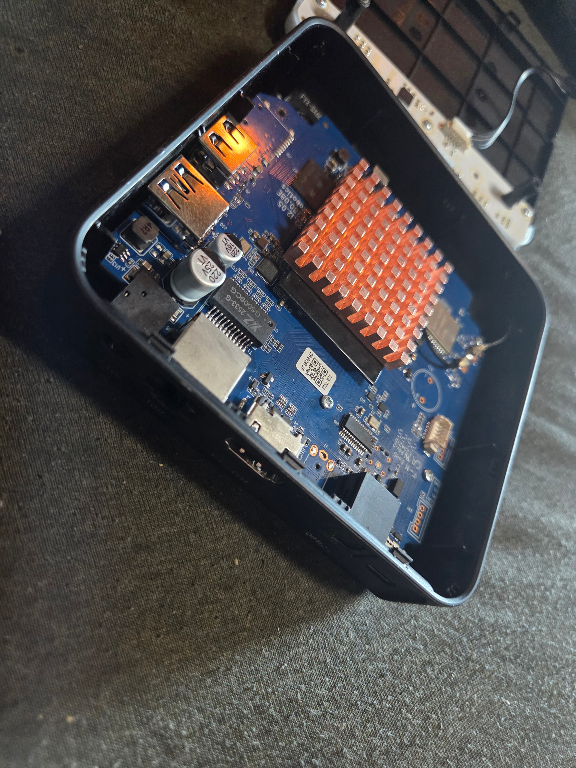

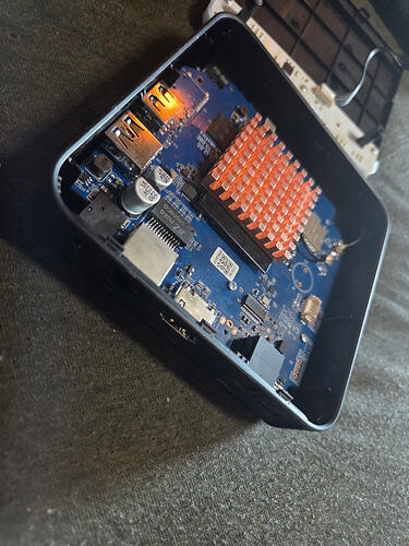

The thing is, there is a design flaw where the stock aluminum plate heat sink , those three screws , the screwheads add an extra 1.5mm gap that disconnects the heat sink and works against it. So you have to remove those screws and maybe glue in the stock metal heat sink
Anyway this mod is stable at 145f will not exceed 155f under heavy load , no fan necessary.

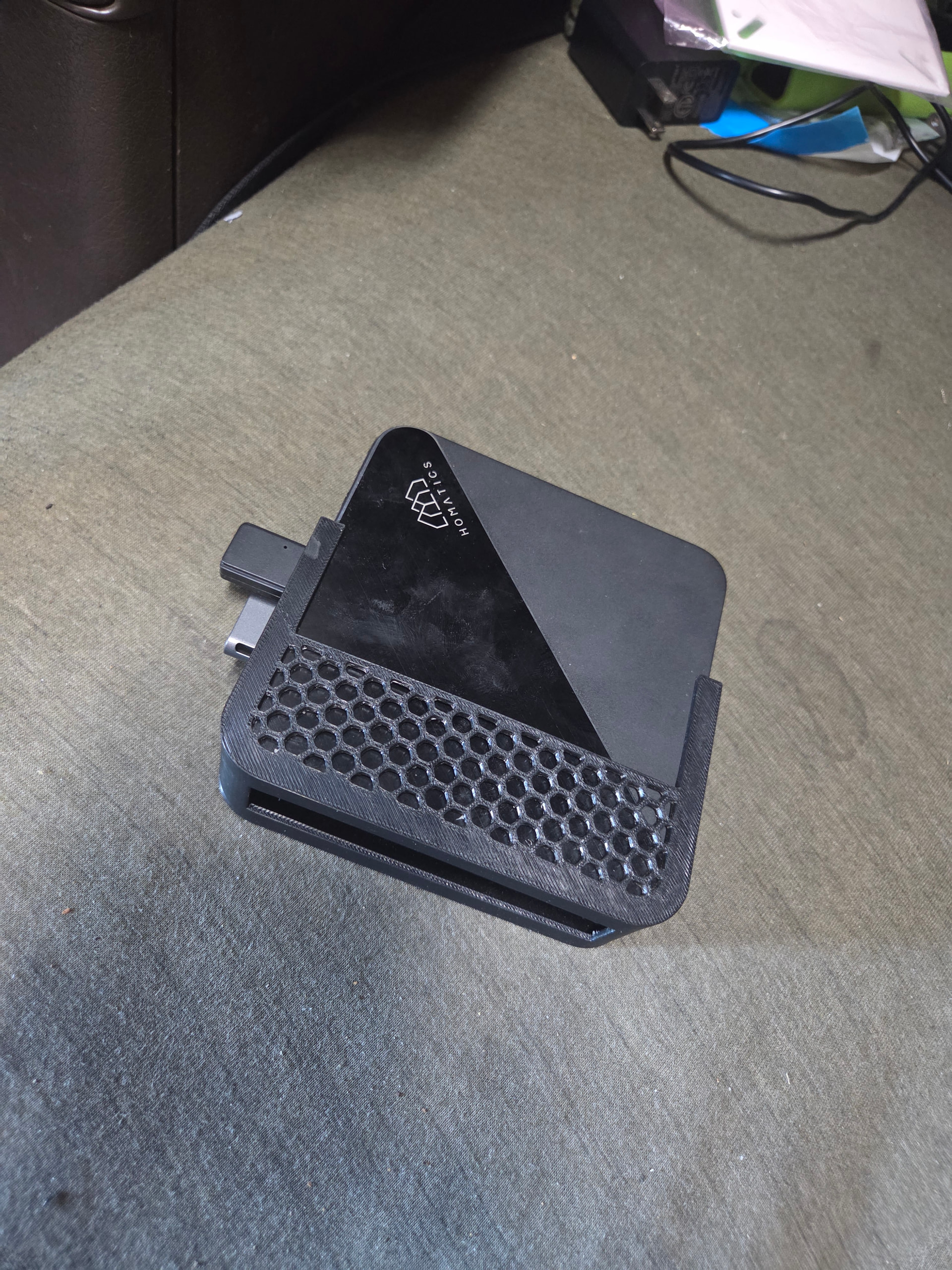

I would like to throw rocktek version in garbage sd speeds are bottlenecked bad ,
The most cpu you can possibly use on these devices is “iptv live 720p to dv” so I use that as a control factor , stock rocktek exceeds 170f after 20 minutes ,. My fanless mod have not seen it exceed 151f

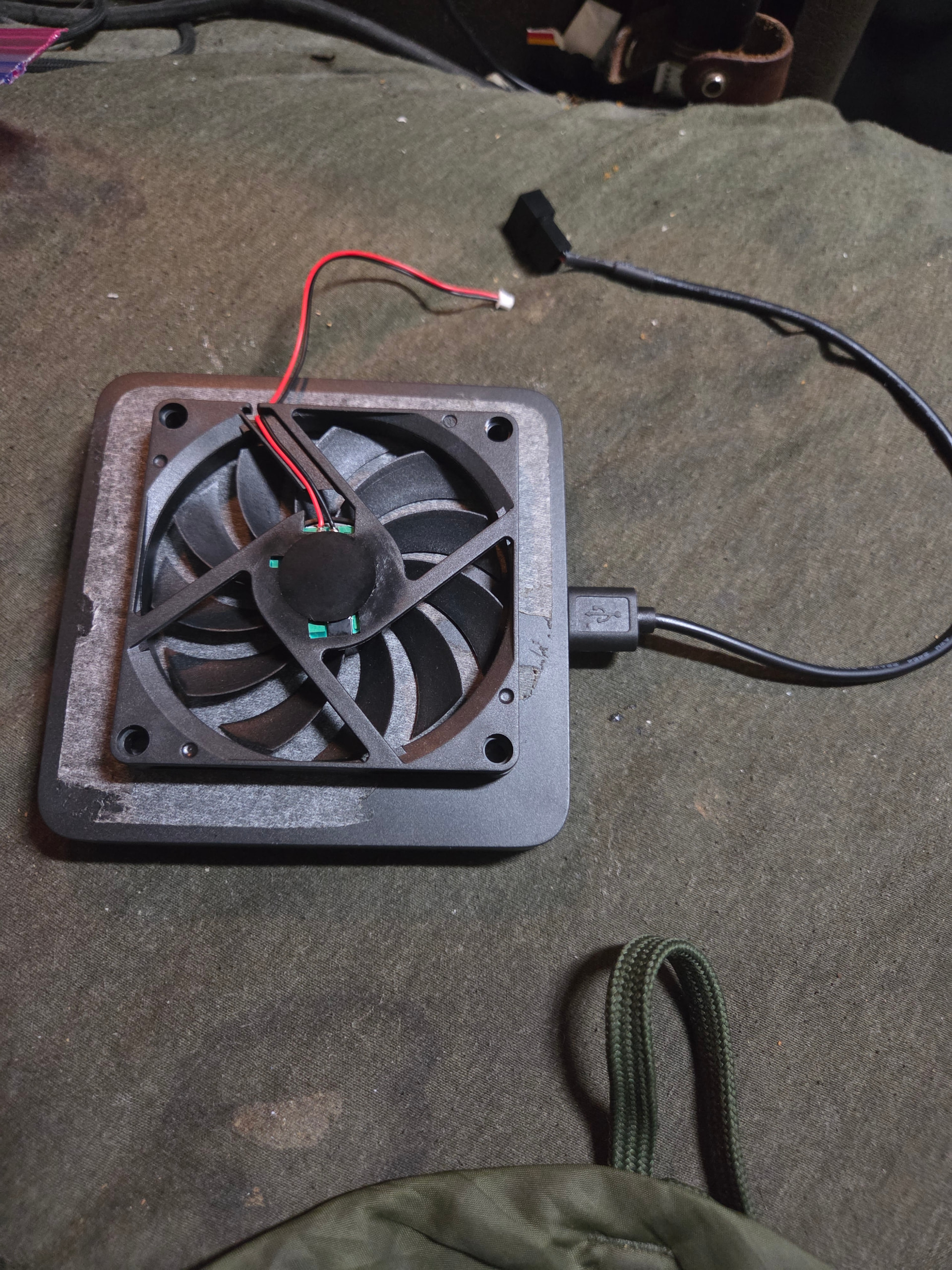

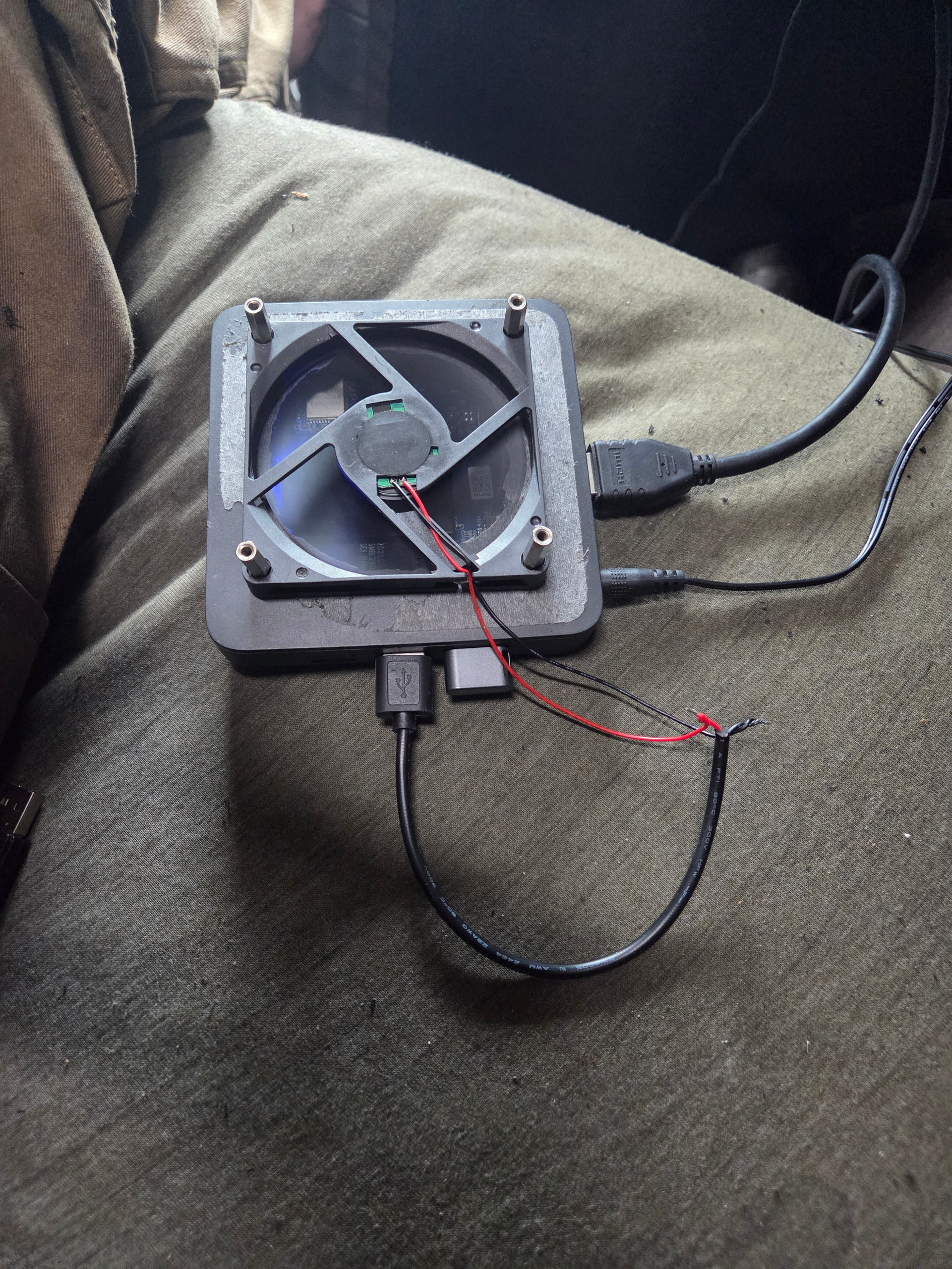

actually, if you’re willing to put a fan on this one is probably ideal.It’s staying at 100f , and despite thermal throttling not starting until 167f , if there’s any acceleration or boost mode, then this will be able to fully utilize it
