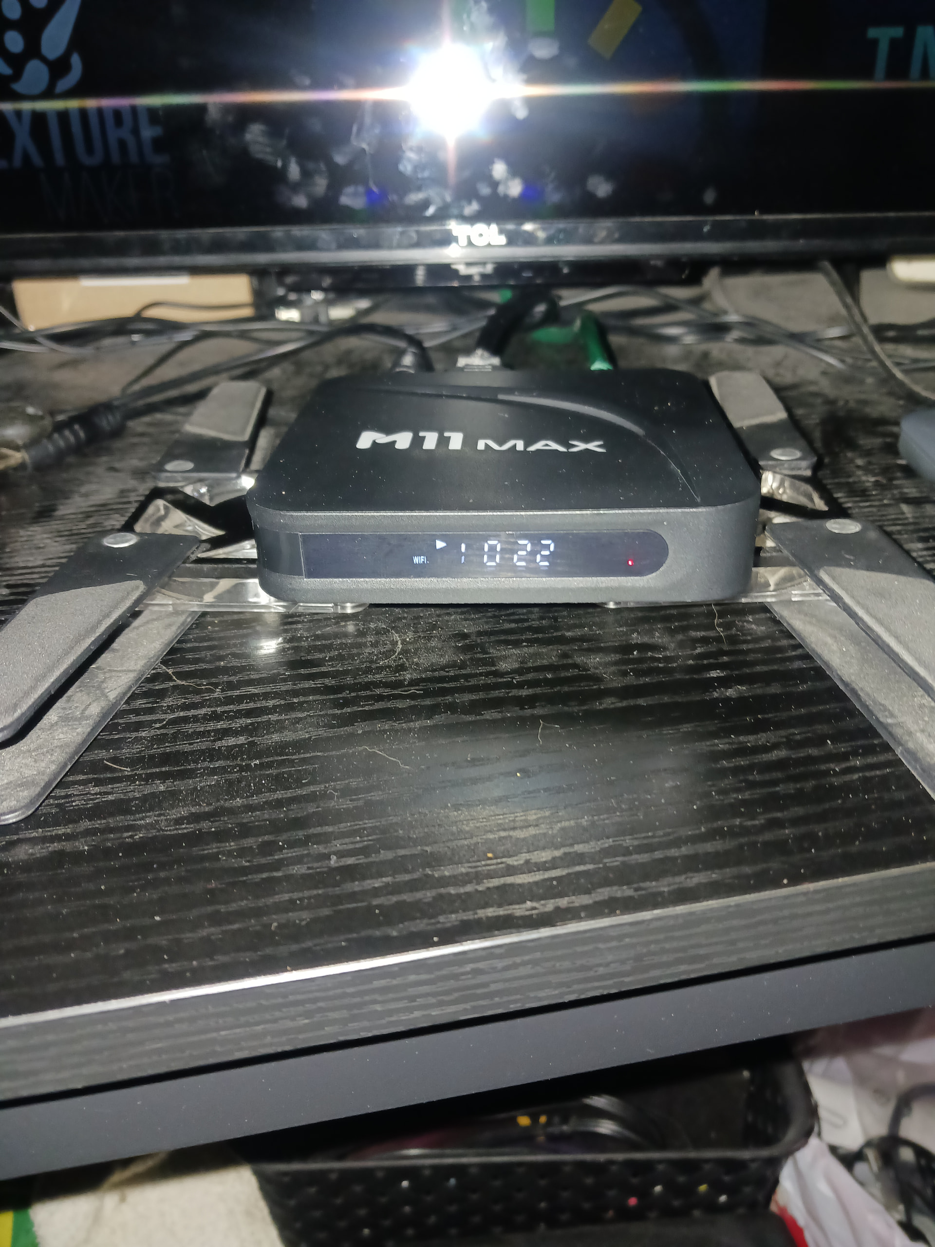

Iam not sure
Just before I posted
5pm approx eastern standards time
Iam not sure
Here is a new image ,which matched the current time, in my local 1220 pm.
The characters from left to right ,How to change/edit?
Can this be done in the addon advanced settings?
Or need to edit the config?

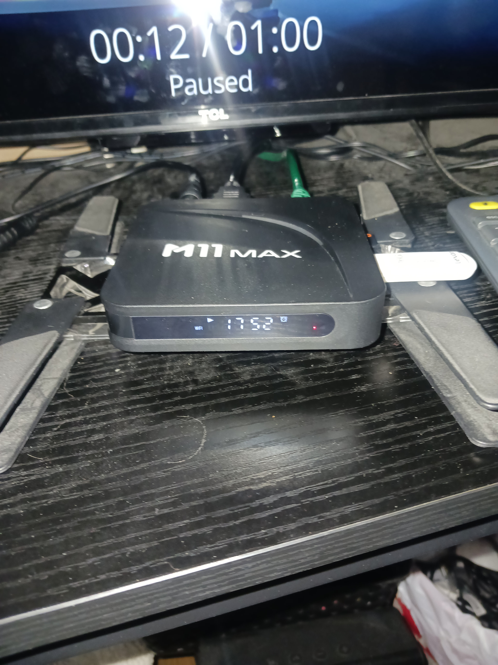

This one should fix the time. You’ll need to confirm that the correct icons are lit.
m11-max-s905x5m.conf (1.2 KB)
Yes, fixes time..!
However USB drive ,wifi icon lites up,play and pause icons are reverse, if I remove Ethernet Cable clock icon goes out.
Do you need dmesg? Grep vfd?
Those won’t help, you’ll need to figure out the order of each icon. It’s the vfd_dot_bits value.
I made some adjustments, I think it should work better now. It would be great if you could connect the box to wifi for a minute to verify that the correct icon lights up for WiFi.
This one fixes all!!
Ethernet/Wifi/USB/play/pause..etc..,I like to set SoC temp for 30 secs,and day and month.5 secs
Both work!!
Thankyou for all your help!!!
Most Excellent!!
Thanks. I pushed the config to the repo.
