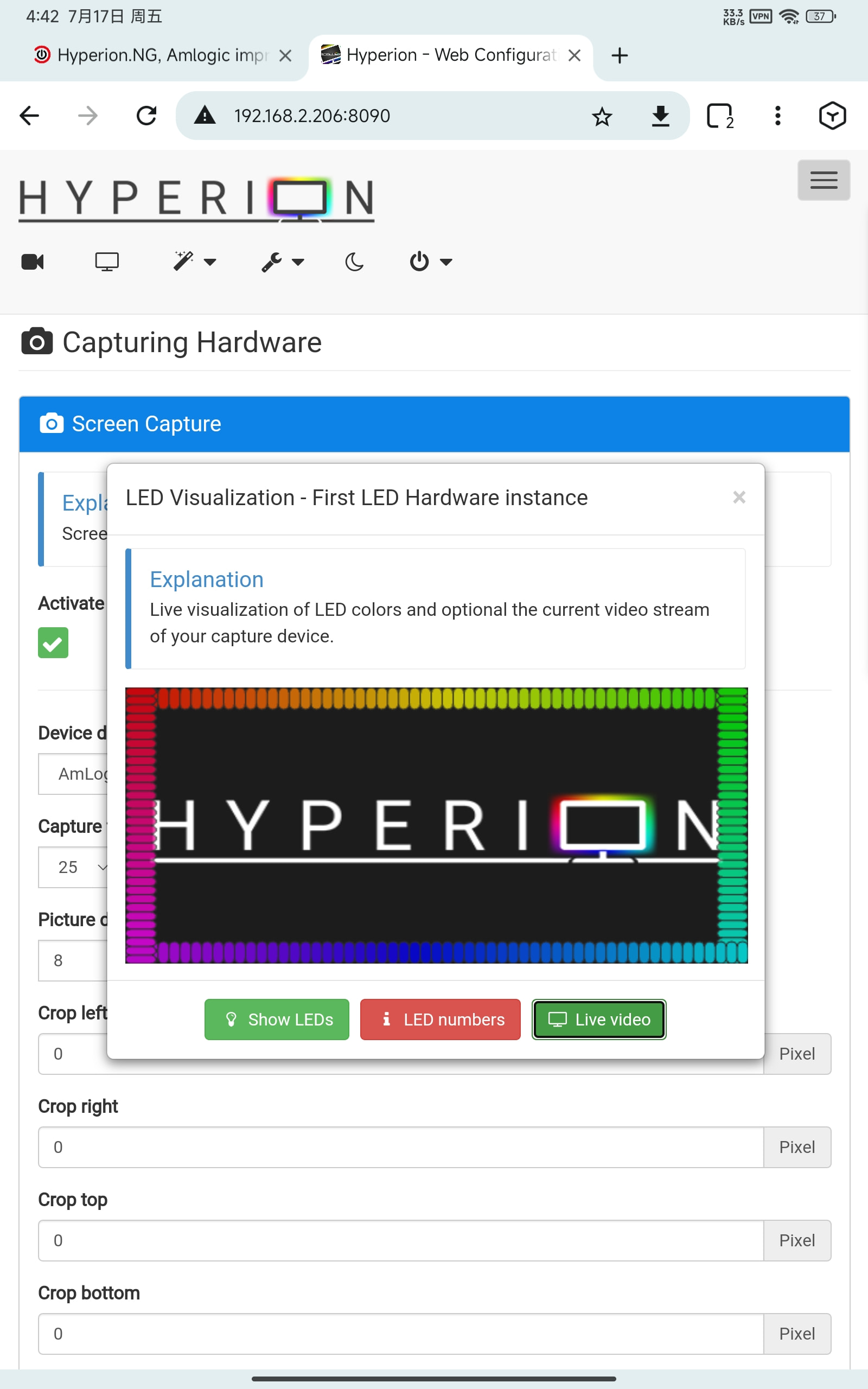

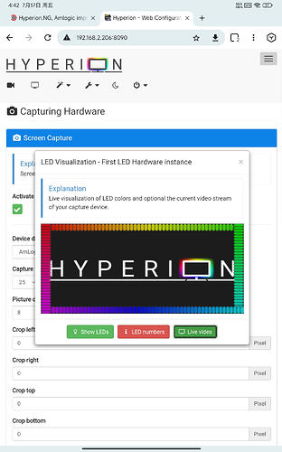

Has the latest system broken the plugin? Screen Capture cannot capture any images. I tried CoreELEC 22.0-Piers_beta1 and Piers_nightly_20260716,Brand new installation. It works normally in ng 21.3.
my device:s905x4 General
After an (automatic) update of the plugin to 22.0.11.122, the Hyperion service won’t run at all anymore. I’m not sure where to find the cause in the logs, but rolling back to 22.0.10.122 (and disabling autoupdate) fixed it. This is on Piers beta 1.
Update to latest nightly. Add-ons aren’t compatible anymore with builds before 20280816.
Understood, thanks!
