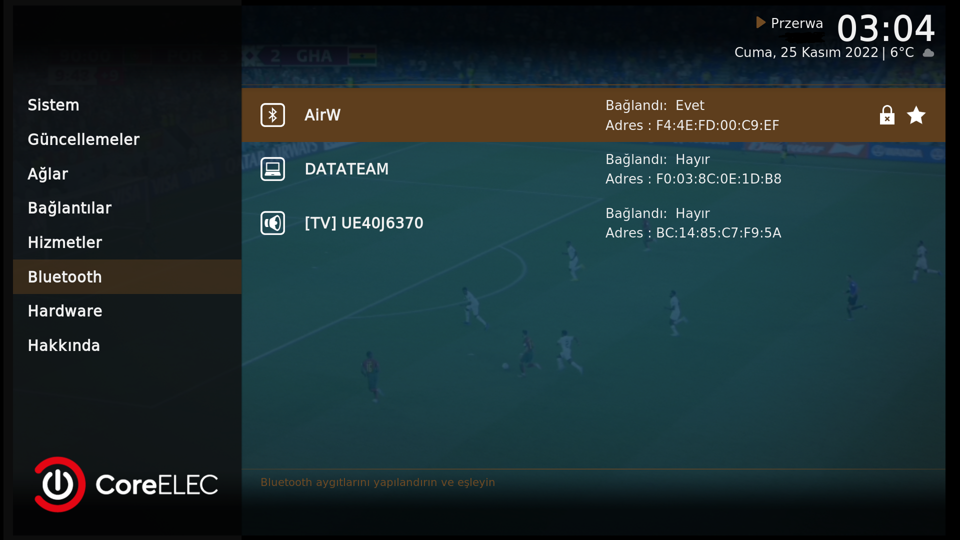

Beelink II Remote troubleshooting:
I put in the remote.conf and restarted the device.
I connected the remote in coreelec
Checked via bluetoothctl
When pressing buttons on the remote should see a response using bluetoothctl.
There is no response from keyboard
Also tried disconnecting from Bluetooth and trying the remote via IR
Although there is a light response from pressing key and also being able to go into Bluetooth pairing mode there is no response in coreelec.
After an addition reboot the remote now works via IR and not connected via Bluetooth. The power button fails to suspend the device, in fact the interface crashes. Can confirm the power button brings the device back from suspend.
Remote control is connected with bluetooth but locked and does not work
I have given up on the Bluetooth. The remote works through IR however the power key is set to restart device but can be used to wake device from sleep. I would like it to suspend rather than restart. Will use Keymap editor when I figure out the IR code.
