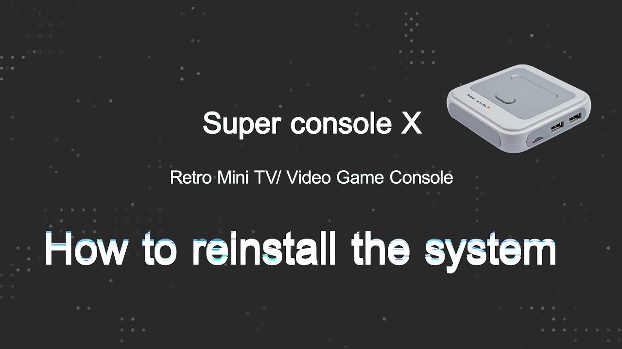

I tried to restore factory settings in Kinhank Super Console Cube X3 using the YouTube video below and now the console doesn’t work and doesn’t boot please help me.
